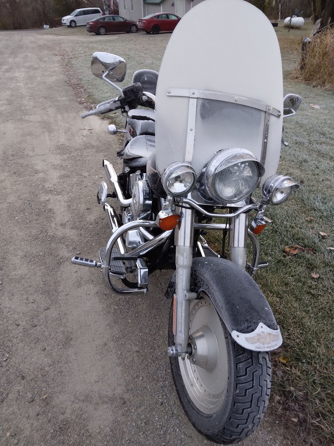

This bike is 25 years old and lives in Wisconsin. It has spent time parked in the winter. Parked with a full tank of non ethanol fuel a couple OZ of sea foam . It has in 25 years never had any carb work done to it.
Don't turn this in to a major project . It is not that big a deal.
Frosty morning . think I will have another cup of coffee before the ride.
