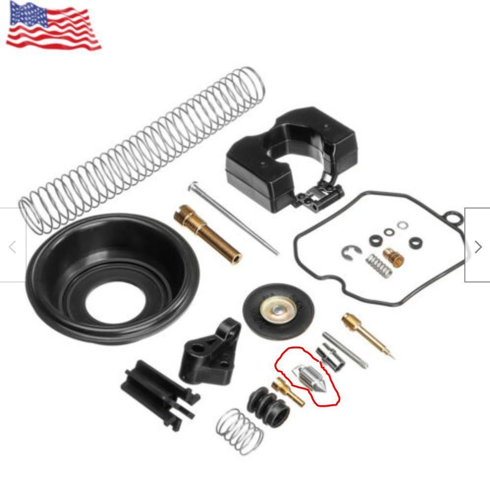

You can visit CV-performance and see what they have for your rebuild, or you can buy an inexpensive rebuild kit on Ebay and pick and chose parts you want to replace. Concerning your overflow issue, you might just need to replace your float valve. I bought one of these kits to see the qualify of parts, and I think they work just as well as others. I used the A/F mixture screw and bowl gasket out of my kit. I would recommend it. You can also visit Nightrider.com and read up on the CV performance section. Like others have mentioned, you don't need to drill out your carb.
Circled in pic is what you probably need to replace. You can find this kit from $12-$20. Good luck.
CVP has very little in stock - at least insofar as rebuild kits. But I have the James Gasket kit that went in perfectly. As did the Dynojet emulsion tube and jets. But according to some I’m now persona non grata for using them lol.

When my carb overflowed it was a 2 fold issue.
I left the petcock open
the fuel line was breaking down internally and a piece got stuck in the float needle
keeping it from seating. A simple dropping of the float bowl drained and cleared it.

With exception of the mixture screw, spring, washer and o-ring, all maintenance parts are available thru a dealer.
Yep, I've probably had 100 of these carbs apart and think I've actually replaced the float valve in maybe half dozen of them. It's most always debris causing overflow problems. When I take one apart with DJ parts, I throw them in the trash, measure/weigh the slide spring and the vacuum port in the slide, go back with OEM parts where needed. Never had a complaint with the finished product.
