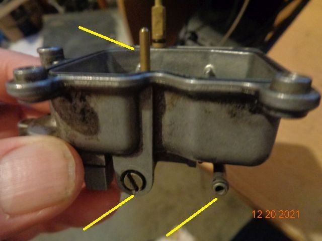

Let's address this overflow problem. First, is this the 1999 FXR2, and one of the carbs is original to it as far as you know? (I'll assume the other is off an unknown, no problem)
Is the petcock the original? (It should be a vacuum operated)
Do one or both or your carbs actually have the drain screw, external overflow nipple and brass pipe in the bowl?

Yes, the stock carb is original as far as I am aware. Disassembly shows all stock components except for the needle and keys. Has an adjustable jet of unknown origin set at the middle setting (3 positions down) with three washers below it. It has a stock emulsion tube and a 180 main jet, and a 45 idle jet. At this point I just want to repair the overflow as it ran great prior. I went to HD and bought a float valve and a bowl o-ring and installed them. Set the bowl level to 10.9mm and am about to install it back and try it out. I’ll report back in 10 min.
