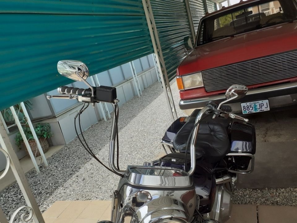

Today she got new mirrors and grips. The REALLY cheap ones I got were trash. The rubber tore out on the grips and the left mirror wouldn't stay where you put it anymore, went short stem this time. Toll was supposed to be here today.
