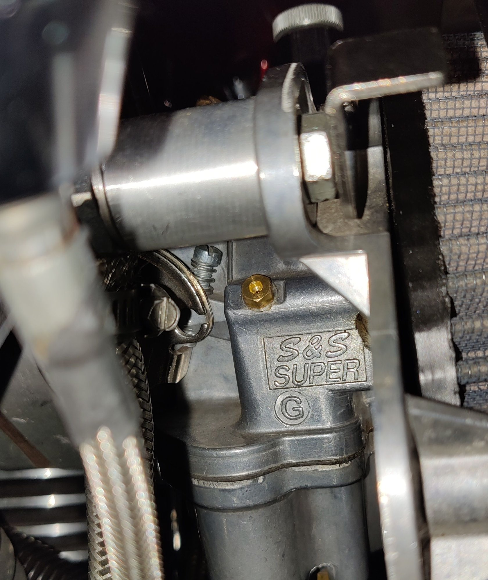

I've been riding my Street Bob Lot lately and haven't paid much attention to the Fatboy (mainly because of a right front fork seal leak). Well the last couple of times I had it out on small errand like trips I noticed on hard acceleration it didn't seem to want to really go . I haven't been running the Wego so I didn't notice any visual issues with the AFR's.. So the other day I took it out again (to get Primary oil for the Street Bob) and while sitting at a red light I'm casually looking down around the motor and that's when I saw on the S&S carb that I forgot to put the External Air Bleed back in the last time I was servicing the bike... Without it the main jet wasn't coming in at all.. Good thing I have a Thunder jet to cover the high rpm's. So after putting Ina Mikuni 120 jet in I took it for a little ride and all I could say was yup, that's my baby...
