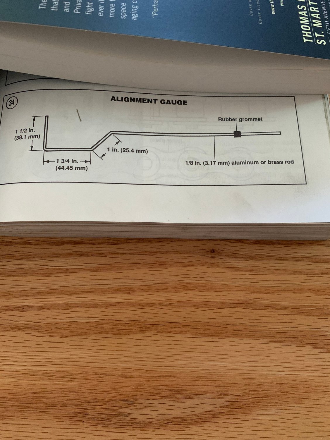

Originally Posted by bulldog1776
Thanks guys. If it is something with the belt would it go away when hitting the rear brakes?
It is possible that it would go away.
Take a measurement from the center of the swing arm pivot bolt to center of axle on both sides. Be as precise as you can, they need to be exactly the same or the wheel will be cocked to the side and possibly cause a squeak. Not sure about the axle adjustments on newer bikes, on mine it’s pretty straightforward you just loosen the locknut and turn the bolt in or out depending on need.
ETA: You might find it easier to get around mufflers and bags by using a piece of coat hanger wire bent to fit exhaust side then use it to check other side.
