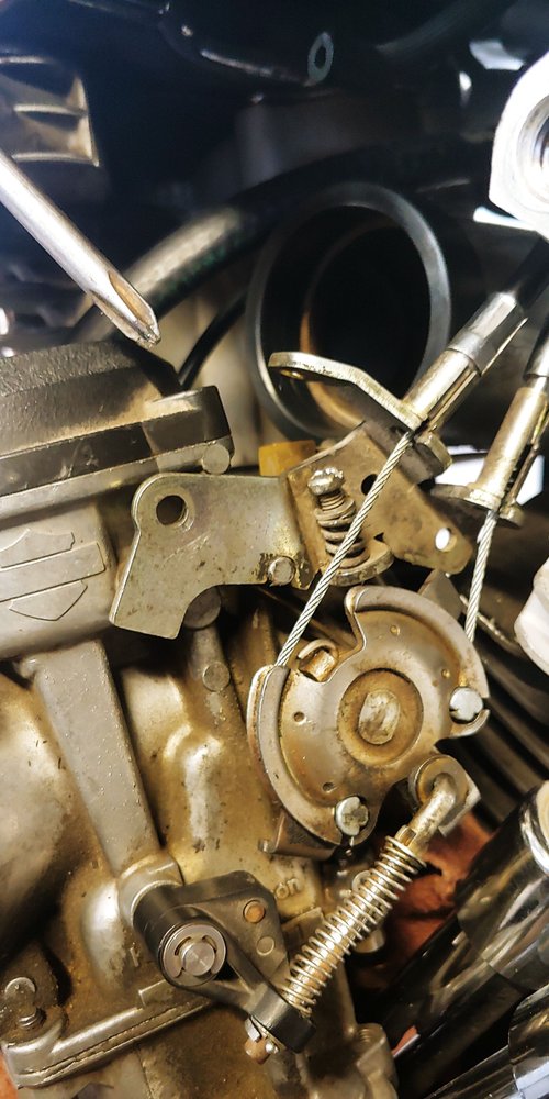

I see 2 things, photo in post #7 - cable not hooked up and the throttle plate is partially open, witnessed by the position of the bellcrank. I assumed you were holding it open. (?)
Post #8 photo - it's still partially open and your fingers aren't in the picture...
Take the top half off the throttle assembly on the handlebars and see if you put one or both of the cable ferrules (#18 in the diagram) on backward. The cable end should sit in the countersunk area so none of it sticks out. A "little bit" at the bars equates to a "whole lot" at the carb end.
Buy a new grommet for the manifold too. Otherwise, when you get it figured out and back together you'll likely have an intake leak if you try to use the old one.
Yes, I was holding the throttle plate open & the cable was out because it doesn't reach. In the pic after, the cables were hooked up because I had the bracket disconnected. Manifold grommet is brand new.

The way most of the throttle tubes are made you really can't get that end wrong, but you mentioned aftermarket grips so thought 'd mention it.. Sometimes it's the simple stuff that's overlooked and will drive you nuts.
Looking again, when you "roll" the bracket back closer to correct position, it'll let the throttle plate close and everything will be more relaxed. There really isn't a lot of extra cable slop to work with on these and with the carb out and away from the manifold, that just makes it seem worse.

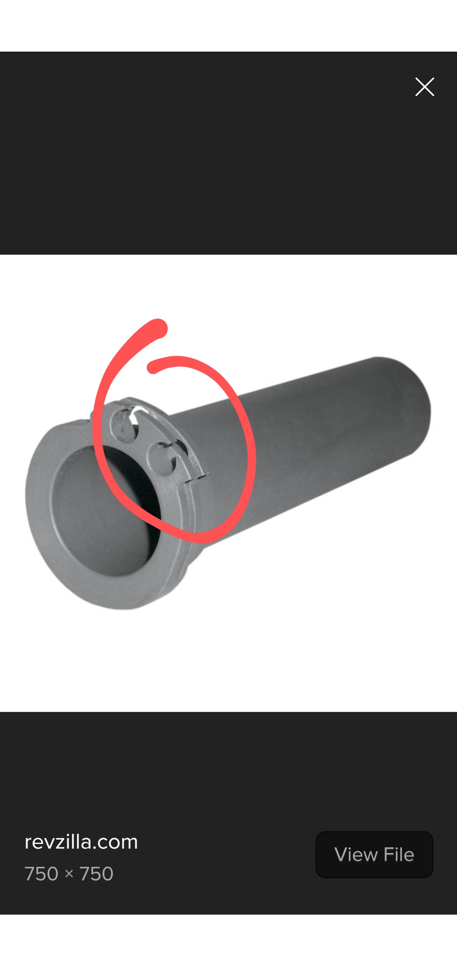

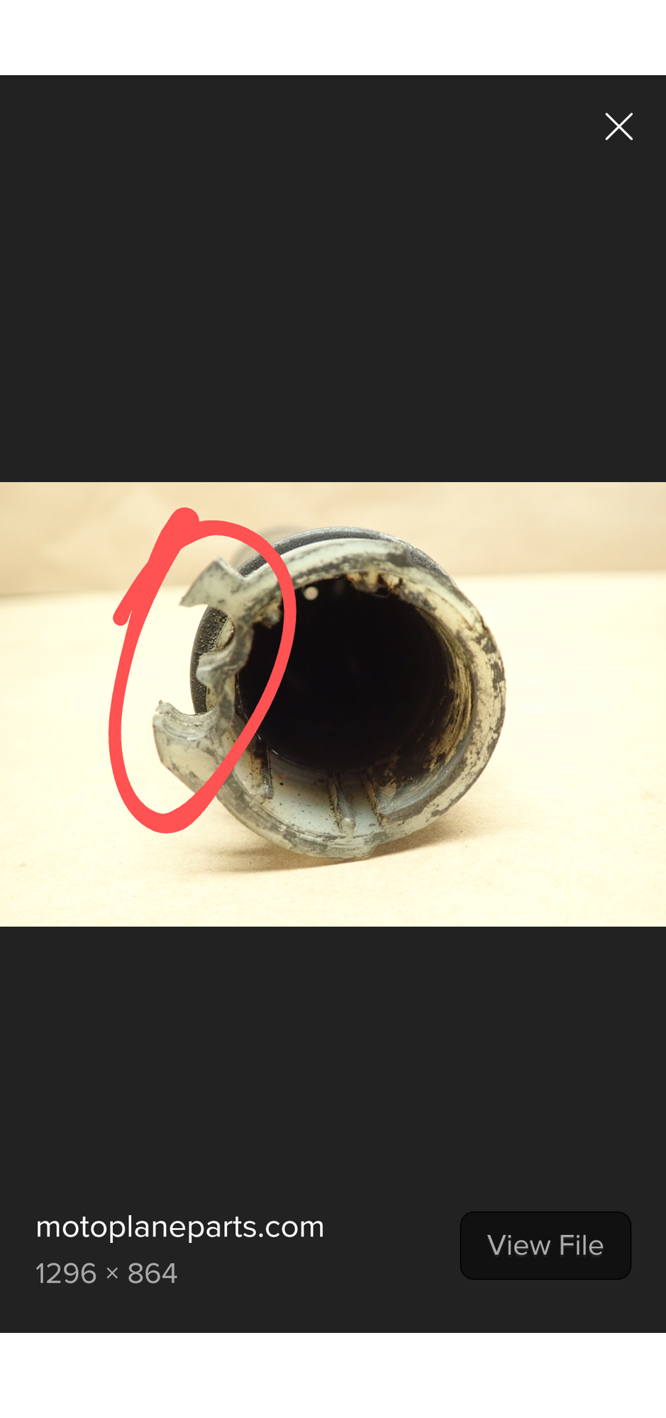

I think I still have the old broken tube so I'll check that tonight. I had no problems until I replaced it, but it was the same exact grip. Maybe they modified the design?

Originally Posted by Trfsrfr
So I took the cable bracket off the carb and was able to get the cables hooked up, but there's no way to reattach the bracket now.
Look where the screwdriver is pointing to to see my issue.
You got the wrong cables. The one you have are for pre-cv carbs..
