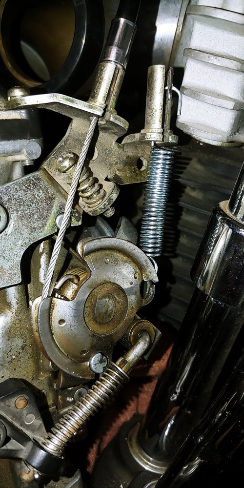

I don't know the part number of the cables as I ordered them a couple few years ago.
I rigged up what's seen in the attached pic.
It might last through the summer...

Just wanted say thanks to all for the comments and info. My fix above works surprisingly well, and I was able to get out with the boys for our first ride this weekend, and that was the goal. I appreciate the insight. I'll be coming back to this post this winter I imagine.
