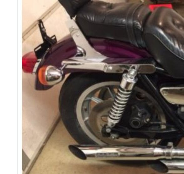

nice bike. there's a support bar that goes from the front pipe to the rear # 65674-87

The original rear tail lights attached to the bike with a long bolt that went through the last hole in the fender bracket.

The Exhaust should be tied together.. ads rigidity... But, on my 1982, I ommited tying together, as I used 65A Mufflers, which are really light weight...and on the FXRP, same ..not tied together, as very light weight muffs...

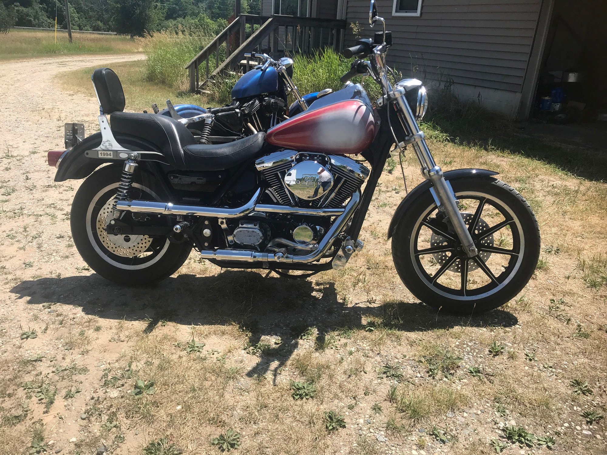

Very nice find.. Looks Great..
Thanks Duffer, I have a pair of those mounts on the way in the post. Plus new fork seals and a pair of progressive springs as one of the seals is leaking and the springs feel like they have seen better days..
