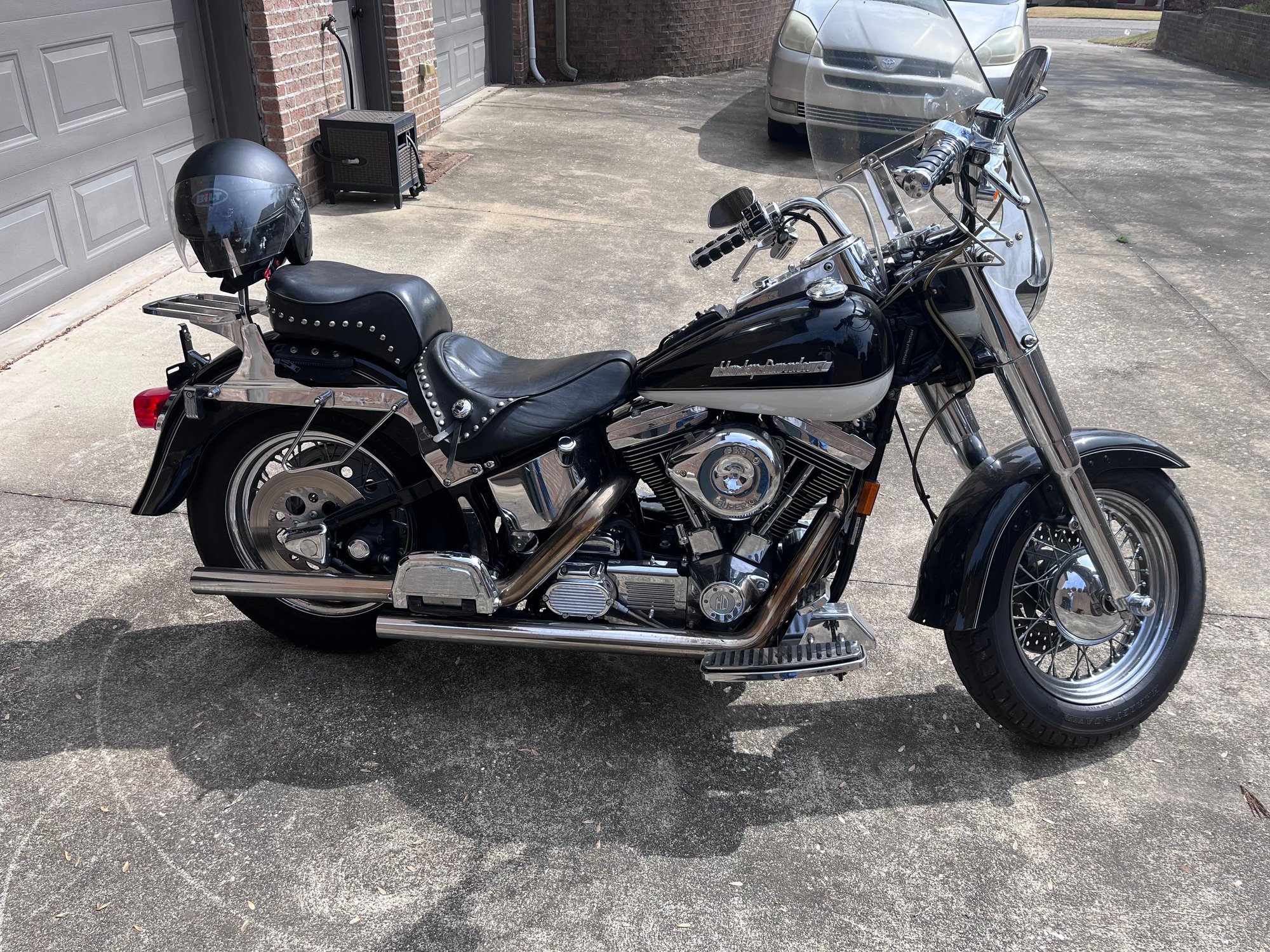

Picked this gem up earlier in the week. Rides like a dream. Got to trouble shoot the brake light staying on all the time but no big deal there I don’t think.
what kind of mag wheel options could I go with on here? Just curious for future reference.
I’m pretty sure it didn’t come from the factory with this paint scheme but oh well.

Review front brake lever switch.
If levers or grips where changed then high probability the rubber tip on brake lever switch at clamp was broken.
Switch works backwards with switch OUT being ON and IN being OFF
