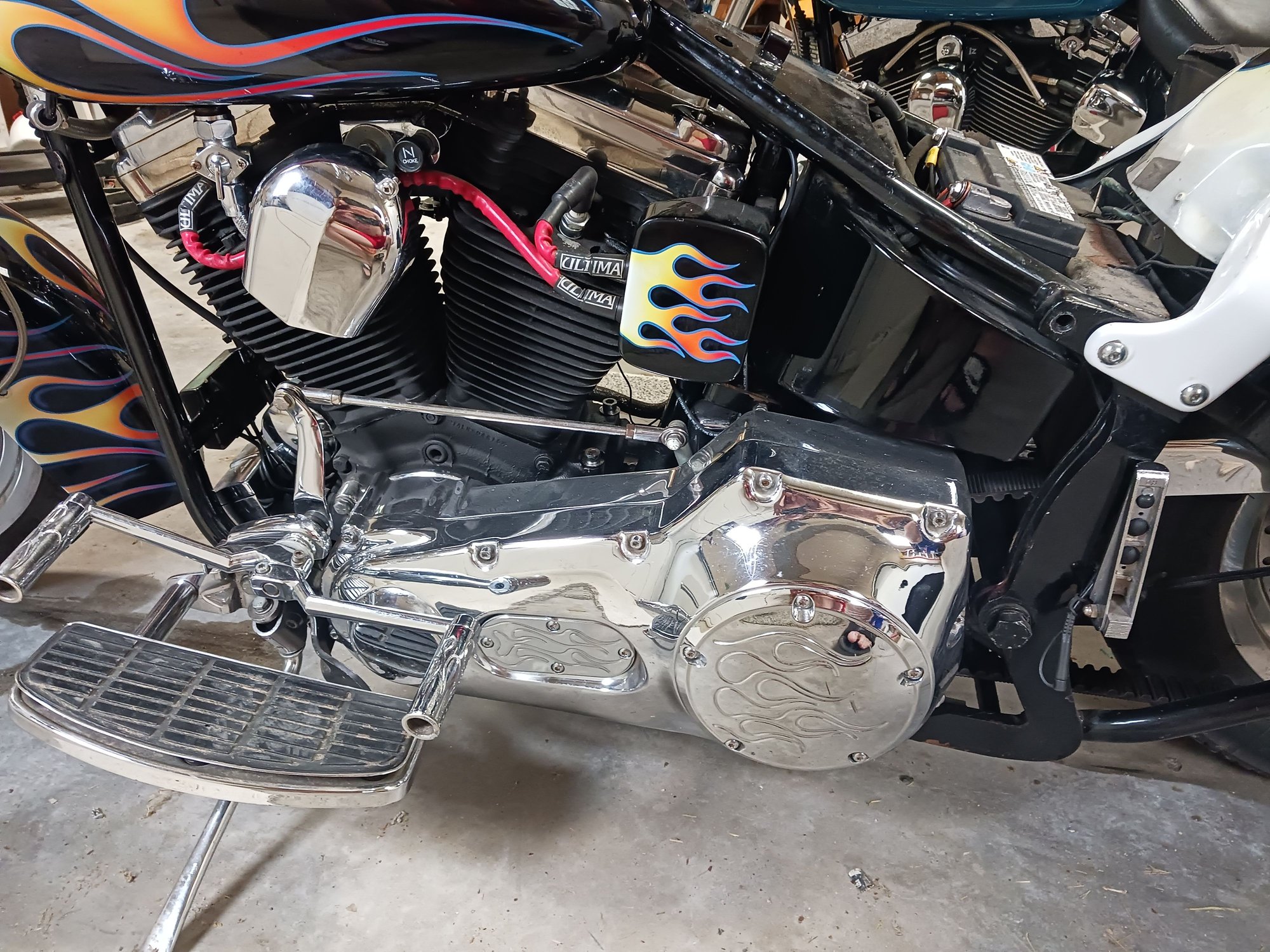

Hard to say for sure since it's a pieced together bike. Does sound like oil pump failure though. If you can post a photo of each side of the bike it'd help with suggestions as to exactly what to check and where. (oil sender location, what engine it may be, oil tank or pan, etc) Probably can't identify everything as to what it was built from, but get you close.

Need photos otherwise you're only gonna get (good) suggestions on things to check that may, or may not apply. Example: check valve leakage is irrelevant if it has an oil pan rather than a tank that's above the pump level.
Without knowing some particulars, suggestions and ideas will confuse you and anyone else trying to help.
