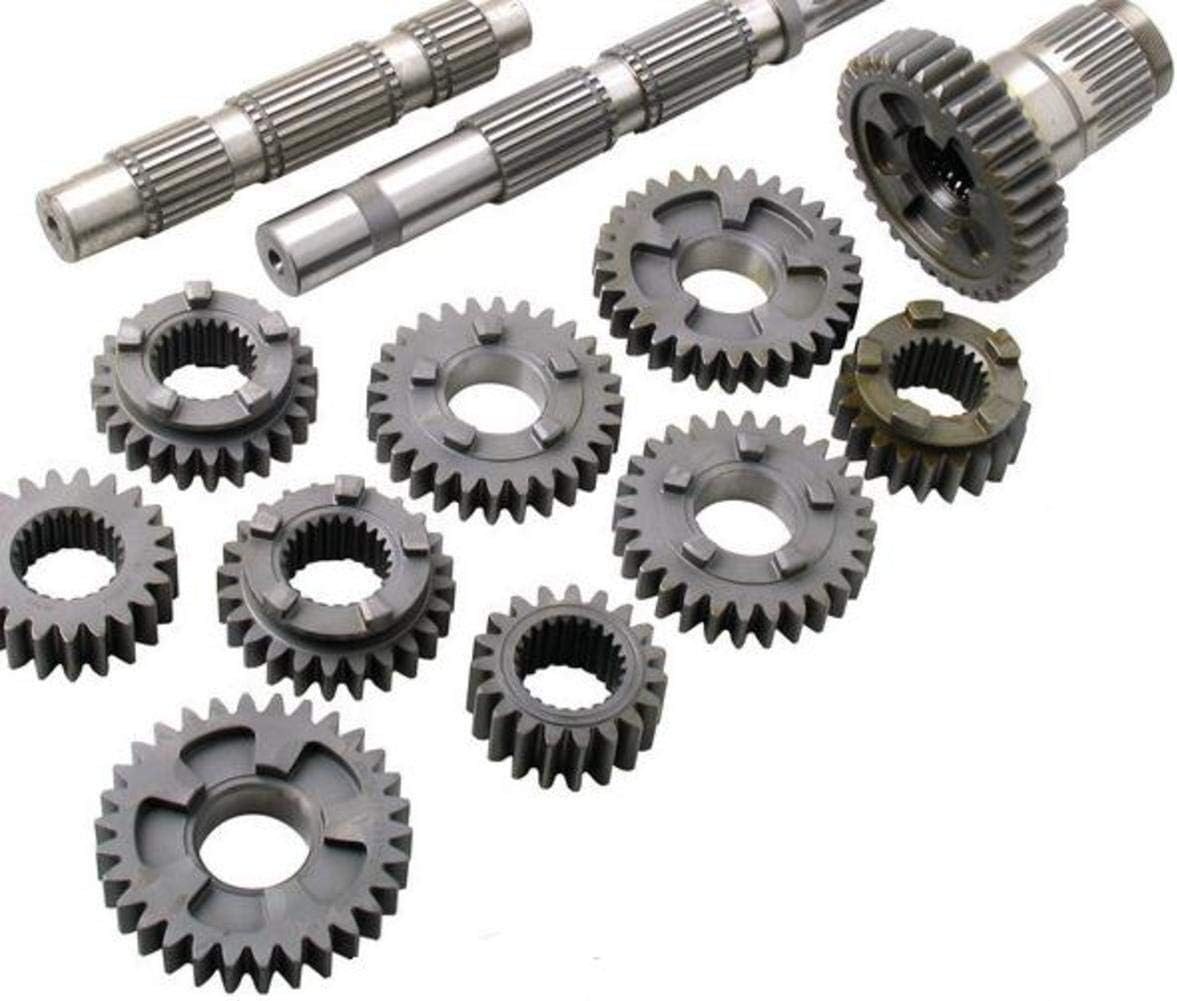

As for down shifting the trans, straight cut gears, so don't high rpm bag down on the gears. The brakes will stop you faster/better than any engine braking can every do. To go one step farther, don't shift back into first gear until you are dam near stopped, since it really easy to round off the tabs sides of the gears by trying to shift in to first when the rear tire is still spinning too fast. Worn bad enough, will not want to shift cleaning in to gears up or down, and may end up with trans jumping out of gear.
And for the love of Christ, use the clutch when shifting, since the Harley trans does not take kindly to being up or down shifted under power without clutch like is a ricer race bike with throttle blipper. It tears the hell out of the gears hence side tabs to indents as show in the above photo, as well as some nasty damage the main rod spines as well. I bring this up, since if you got the bike used, may have been the way someone was shifting the bike before, and may be time to pull the trans apart to go through it, if the pawl adjustment and clutch check, does not solve the problem.

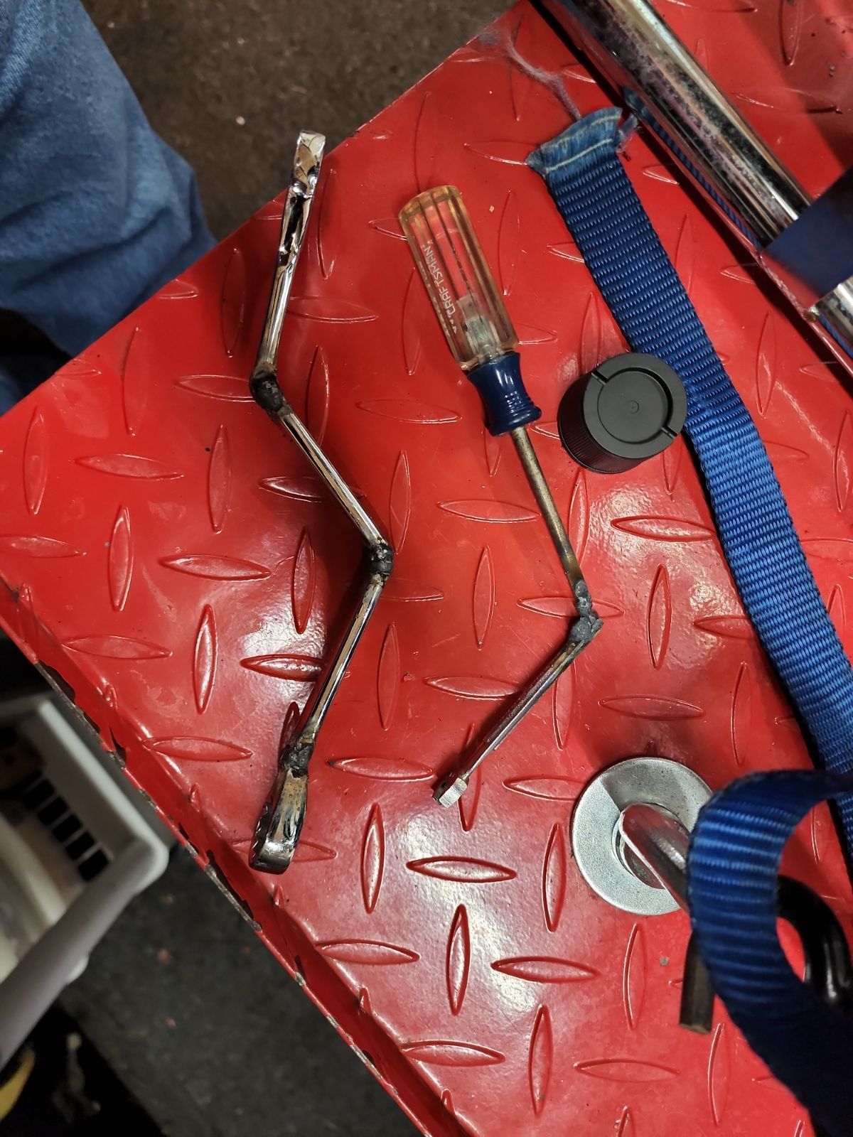

After getting some paying work done, I opened up the trans top. As predicted the shifter pawl is out of adjustment. I spent some time thinking about how to get at everything without tearing the bike down too much. Decided to fab a wrench to get at the 11/16'' nut, and wing the adjuster.
With the right tools this looks like a under hour job. Otherwise a knucklebuster. With everything in place and improvised wrenches. Going to try and get it done tomorrow evening, hope I have time. Supposed to register it in my state Thursday, made a appointment and everything....otherwise it'll hold for another year on the out of state plates...

Took longer to make the damn tools than to do the job. Also was a good excuse to change out the o-rings on the oil spout, the bottom was squared off.
The 11/16 was needed, the 1/4 not at all. That said, the adjustment was fully out of wack. The pawl is now centered, and the trans shifts nicely on the table. I'll get out tomorrow or Thursday for a real test.

Still trying to figure out the home made wrenches. Last time I did a pawl adjustment, with the primary still on, did so with standard wrenches.
I'm not saying its not tight between the primary and the trans, but there is room to work in there from the primary side.
