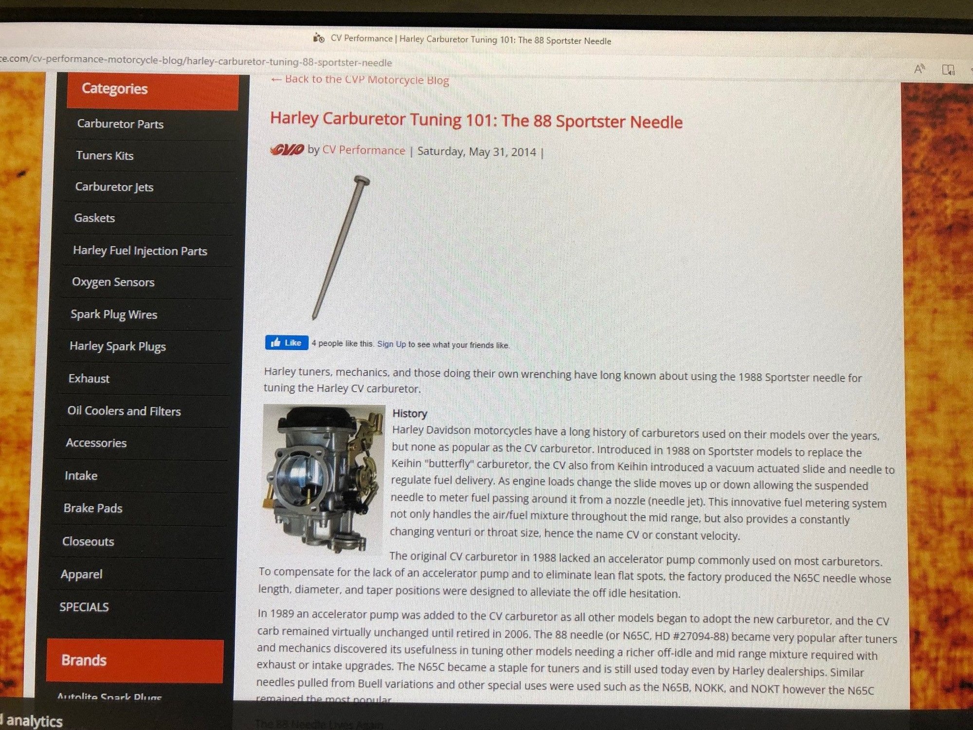

This what you want
Old Aug 19, 2024 | 07:25 AM
cobra23's Avatar
cobra23
Joined: Jun 2013
Posts: 1,052
Likes: 952
From: Sarasota Florida
I agree with eighteight. I put one of those tapered needles in my bike and gained 10hp on the dyno.
Old Aug 19, 2024 | 07:50 AM
jeeperjo's Avatar
jeeperjo
Joined: Aug 2020
Posts: 146
Likes: 48
From: Louisville, Ky
This is the picture of the main needle. I actually have this. No i'm talking about the needle that the float operates. Some have three lobes and some have four. The needle that shuts off the float of gas from the bowl as the float goes up and down.

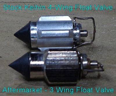

I use the three lobe float needle. Four should be fine as well.

Use the OEM 4 wing float valve.
The 3 wing sometimes gets cocked and does not fully close off the fuel.

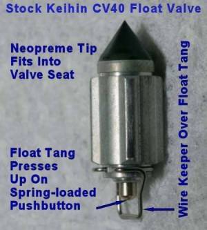

In This XLForum Thread there is a discussion of the float bowl overflowing and the possibility that it is caused by aftermarket float valves that are not of the proper design.10)
