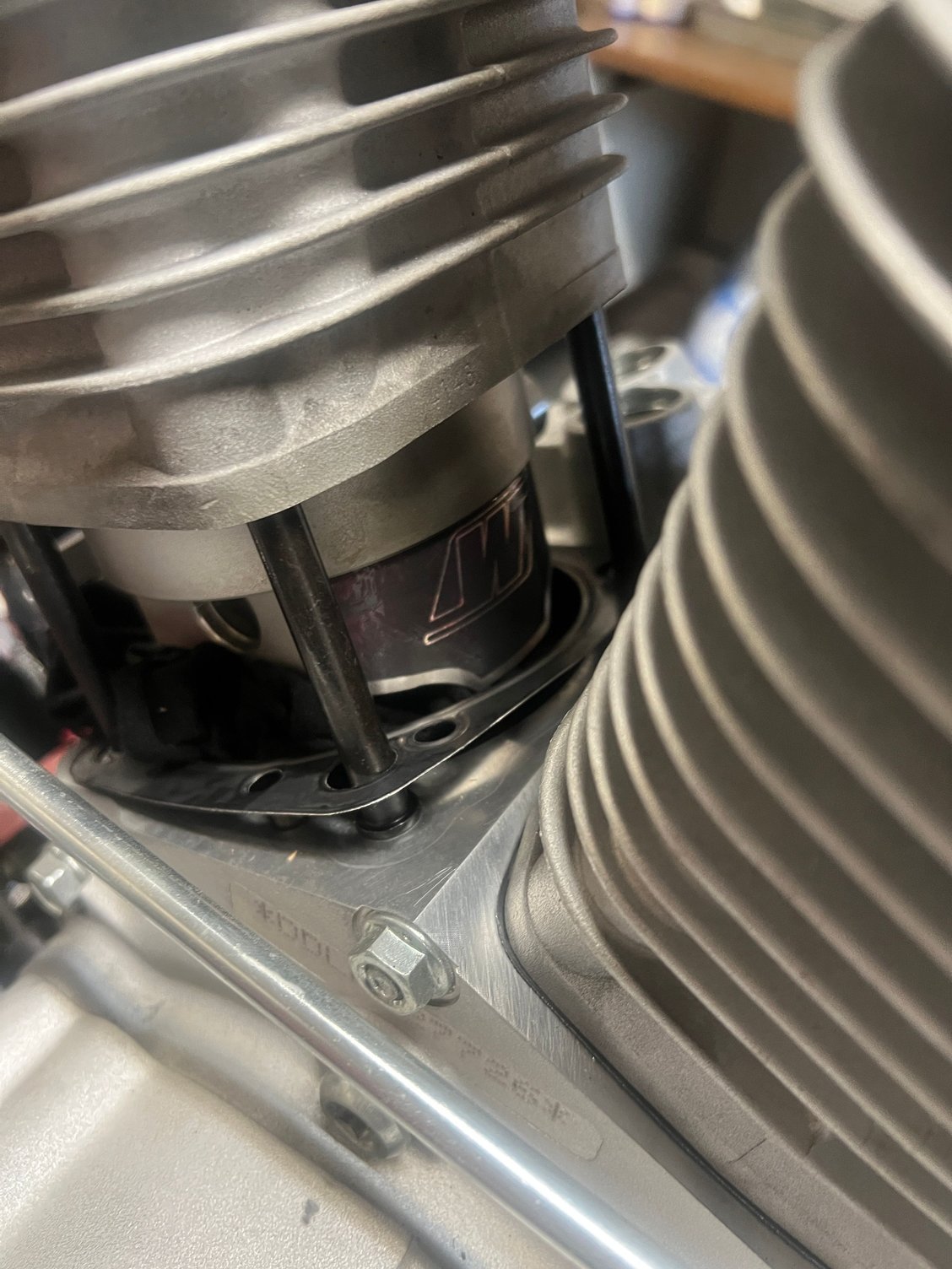

Got the bott end buttoned up. Been a rough few weeks battling COVID. I'm following the book timing the cam and breather and the old man was adamant I was not doing it right since the timing mark on the other side wasn't showing and my rods at bottom dead center. Had to spend a half hour showing him the book and if I was at the timing mark on the flywheel vs what's on the cam nothing lined up on the cam side. He's still thinking I'm wrong. Lol. Yeah if it was an car engine things are different. I'm simply following the manual.
On a good note. Once I got the new gasket in and torqued the cover to spec my cam end play tightened up to about .015. I can definitely live with that with a 50 thou shim in there.
Time to get the jugs back on. Woo!

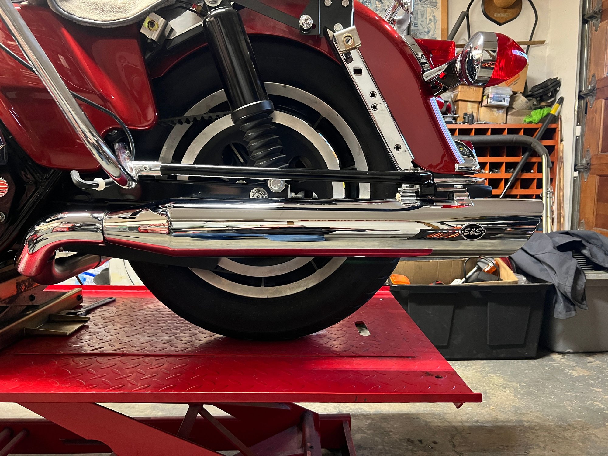

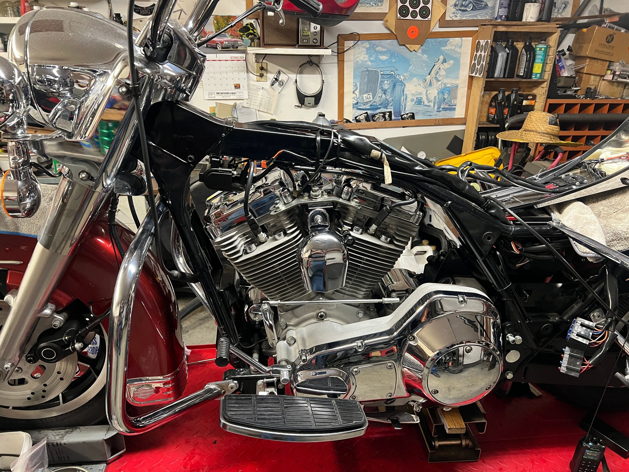

After a few back ups. (missed a bolt under the rocker covers) and then the choke/enrichenener snapped as I snugged it up. And both my parts carbs have already been harvested of those. She's pretty much back together.
I still have to remove the transmission cover to install the EZ pull kit (I might not) and the oil filler cover to remove the exhaust bracket and install the new one. Finish the fluids, and reinstall the body work, I got a massive amount done today. Getting antsy to hear this thing fire up.
Oh and getting them push rod tubes back together with all new O Rings. Holy Cats that wasn't fun.
