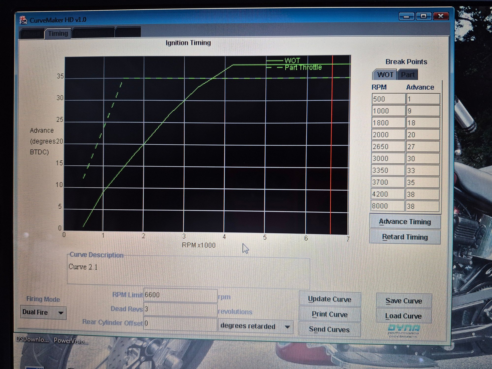

Here's a curve I used to run on my D2KI though without issue..

Okay so I checked the three different ignition modules dynatech, Screaming eagle and the Chaiwanese crap... The only one that curvemaker would talk to was the D2KI, it wouldn't even talk to the Screaming Eagle module.. I guess to keep with any EPA settings they don't want anybody going in and changing the ignition curves. I couldn't even view them because it didn't see the module which is kind of too bad because I want to know what the ignition curves were like on the screen and eagle modules.. oh well, is what it is, 50 bucks is 50 bucks..
When everything works perfectly, it WILL NOT let you (or anyone else) see the curve that has been programmed into the module. Will only tell you whether it's set to switches or on e prom so no one else can see what curve you use.
If it has has been programmed and a pin set, unless you know the pin # no one can change. They do that so no one else can change what YOU programmed.
I like your curve. Had one very similar (WOT) to resolve a pinging issue after new cam and top end work. However my part throttle mirrored the WOT throttle but just came in sooner in the RPM's. Also, I topped out at 35 degrees advance. Did some rejetting and programmed the Dynatek curve #2 and all is good.
Interesting that you are having the same curvemaker issue. Windows 10 version XX problem? Conflict with another program? Who knows.

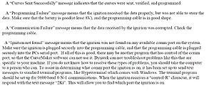

No. . It plainly says in the CurveMaker instructions They do nut work on computers and if you can't figure it out, take it some where that can. The PCs I listed earlier - one is XP another Win7 all others are Win10.
