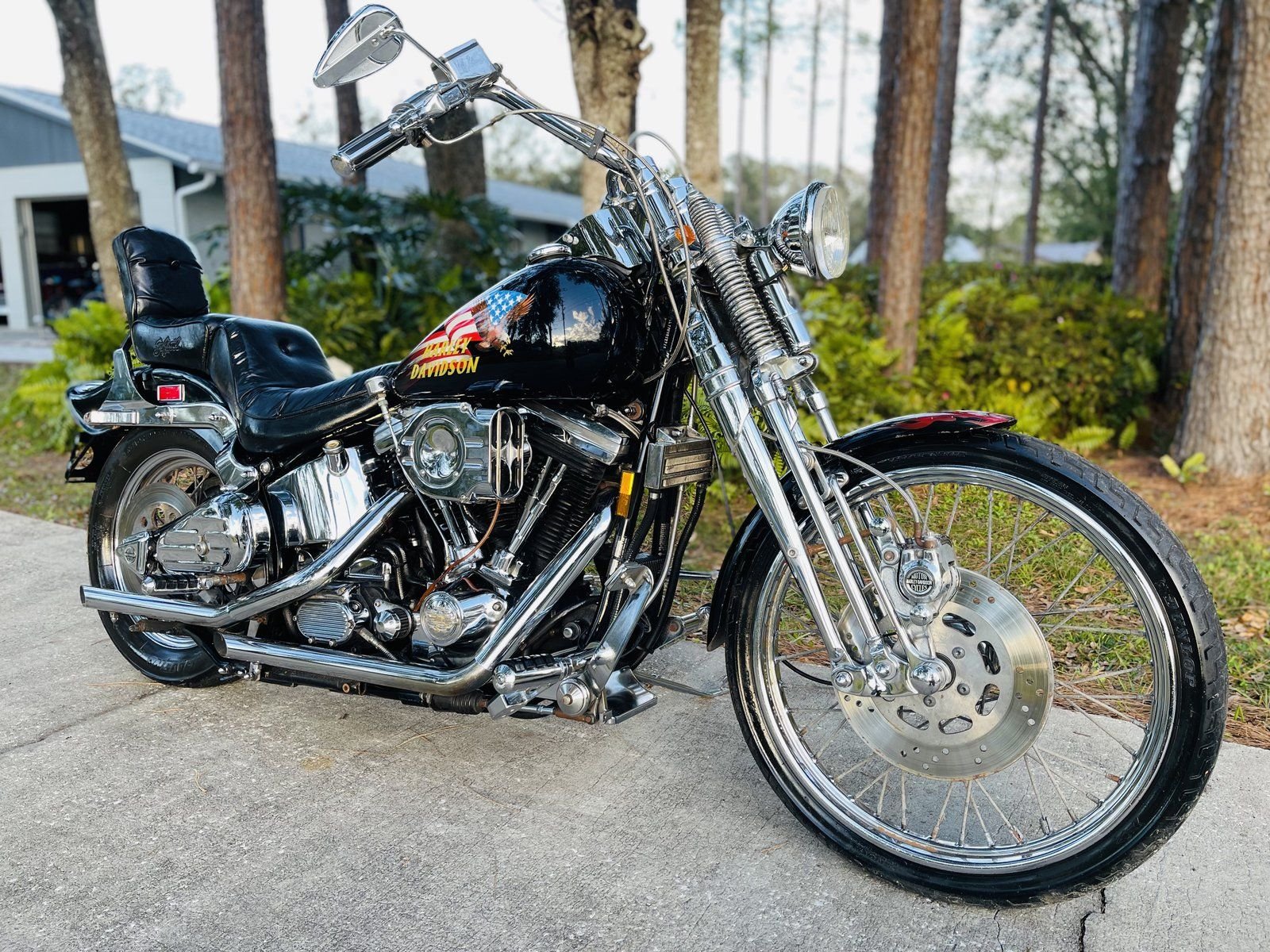

Finally, it's time to start assembling the 1989 Springer Softail that I bought last year in Florida. It was submerged during the two hurricanes in 2024, and was sold as a project bike, and the seller disclosed the motor didn't turn over. I got it cheap, and took it apart last winter.
This is what it looked when I bought it, a real time capsule from the 1990s

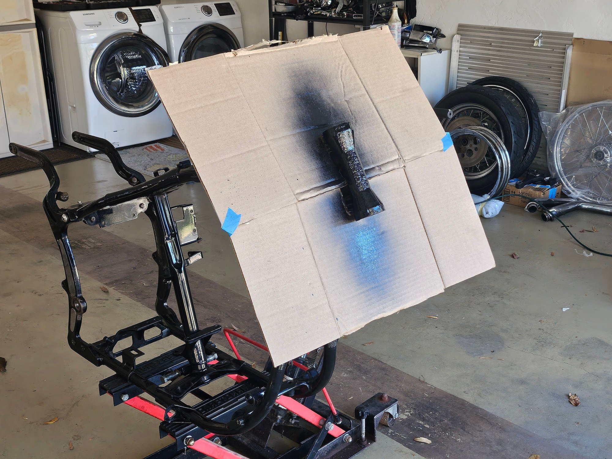

First thing was putting the frame on the stand, wire wheel all the rusty areas, and clean it all up with mineral spirits. I also did the swingarm. It's hard to see but both of the big forgings on the back of the frame looked pretty bad. It's all surface rust, but it had to go. The steering neck, and motor mount also needed work
I didn't need to mask off everything, sometimes a shield works.
But I did mask the other areas and protected the floor.

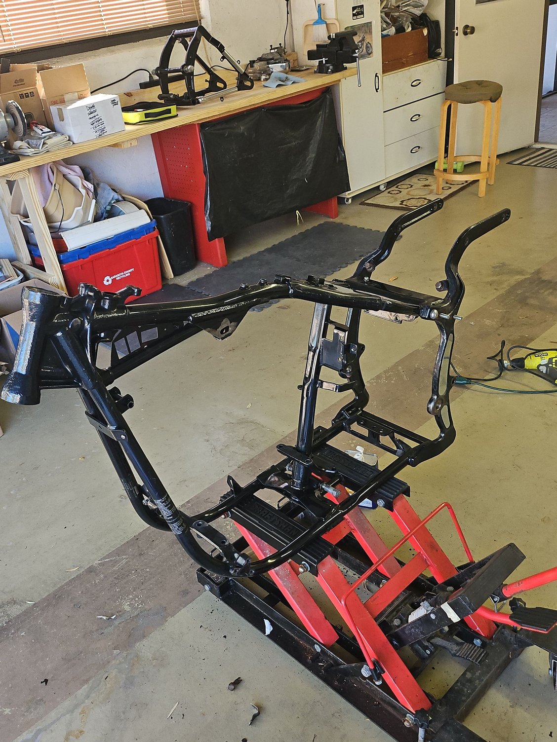

Now it's ready for assembly.
I will bring the motor out to the garage and install the bottom end first. Then the cylinders and heads, etc. It'll be a lot easier to carry that way.
