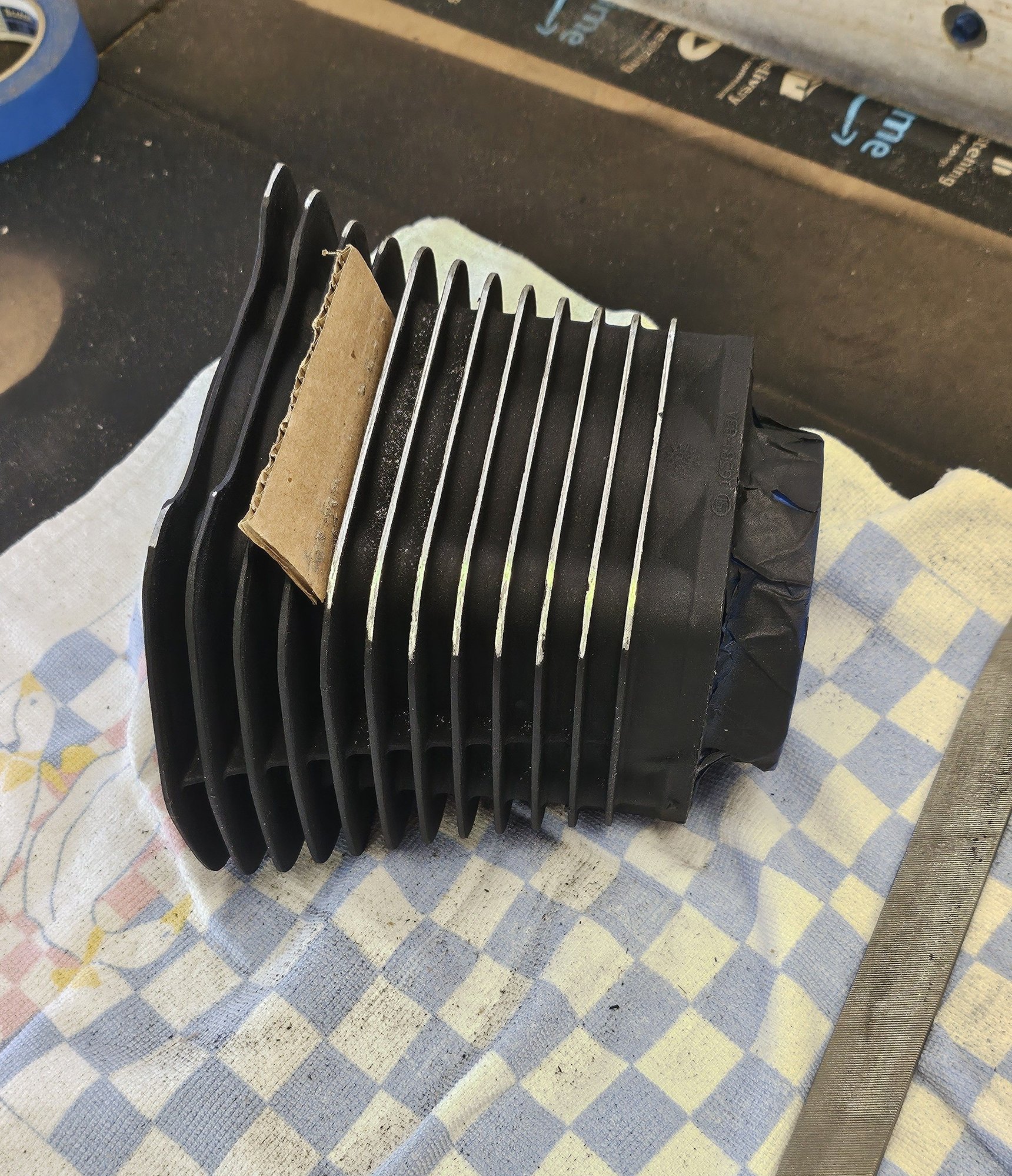

I am glad you are going to file the fins, ruins the look when guys leave them black, That said, I do not envy you for having to do it. Carry on.
Yeah, it was tough, almost two hours of sitting in the garage with the doors open, listening to music. I may have gotten a blister from the file though.
The edges of the fins were not as smooth as I expected. Maybe these cylinders came off a silver motor, that someone sprayed black.
After my lunch break, I'm going to put the pistons and cylinders on.

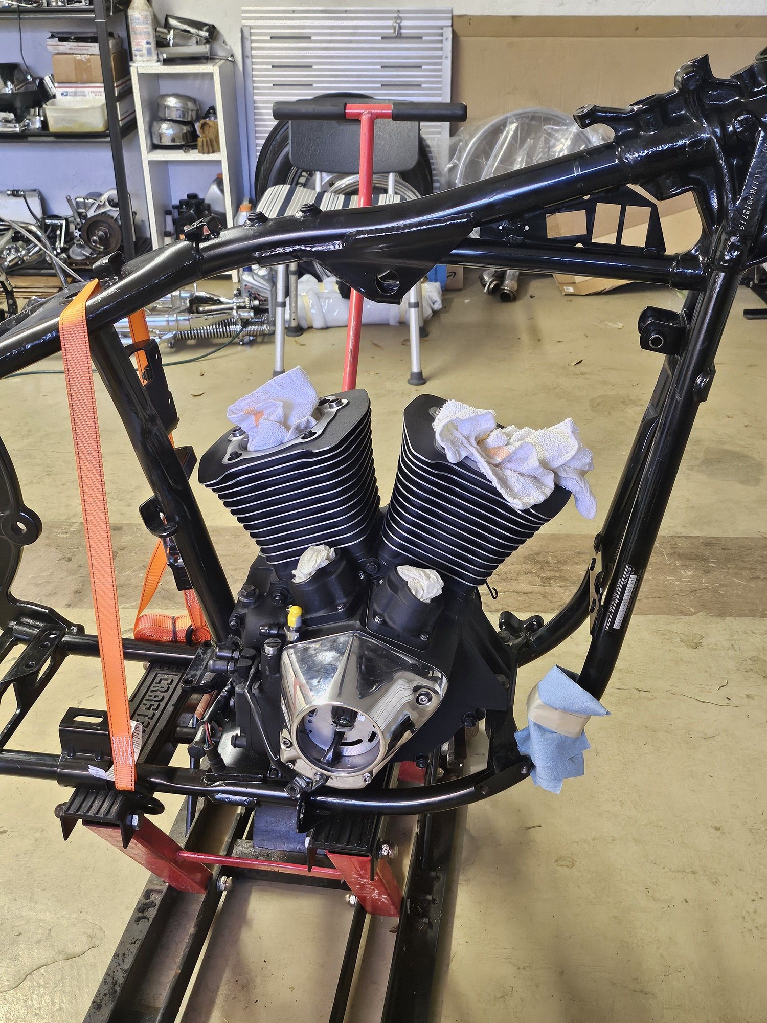

To be honest @Rains2much, I never thought about it, I had the shop put the bottom end together. But I'm going to say just torque it like normal, and the clip won't affect the torque. And thanks, I'm having fun.
The pistons are on the rods, and ready for the cylinders. Years ago I could install cylinders with my fingers, but maybe EVO cylinders don't have the same taper as shovelheads. So I ordered a ring compressor, after looking at two local stores. I checked the ring gap in the cylinders, and oiled everything up real well. I was having so much fun I didn't take any pictures except this one.
I'm looking forward to finishing the top end. I'm not looking forward to doing the fins on the heads, lol.

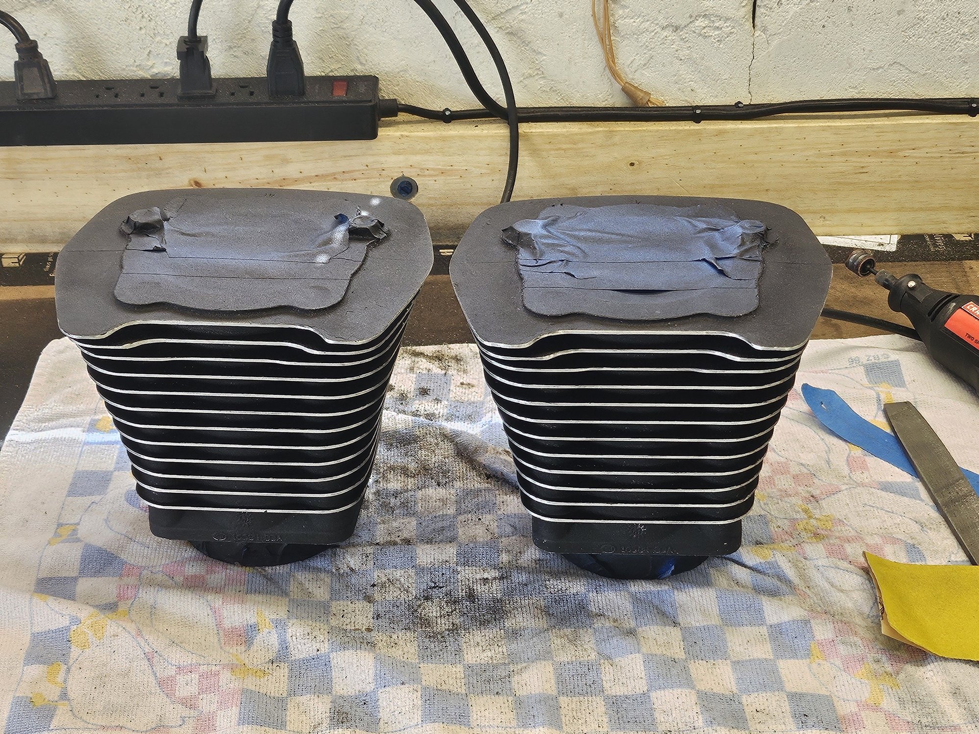

It's been a while, but I got a bit done. The ring compressor came in so I installed the cylinders:

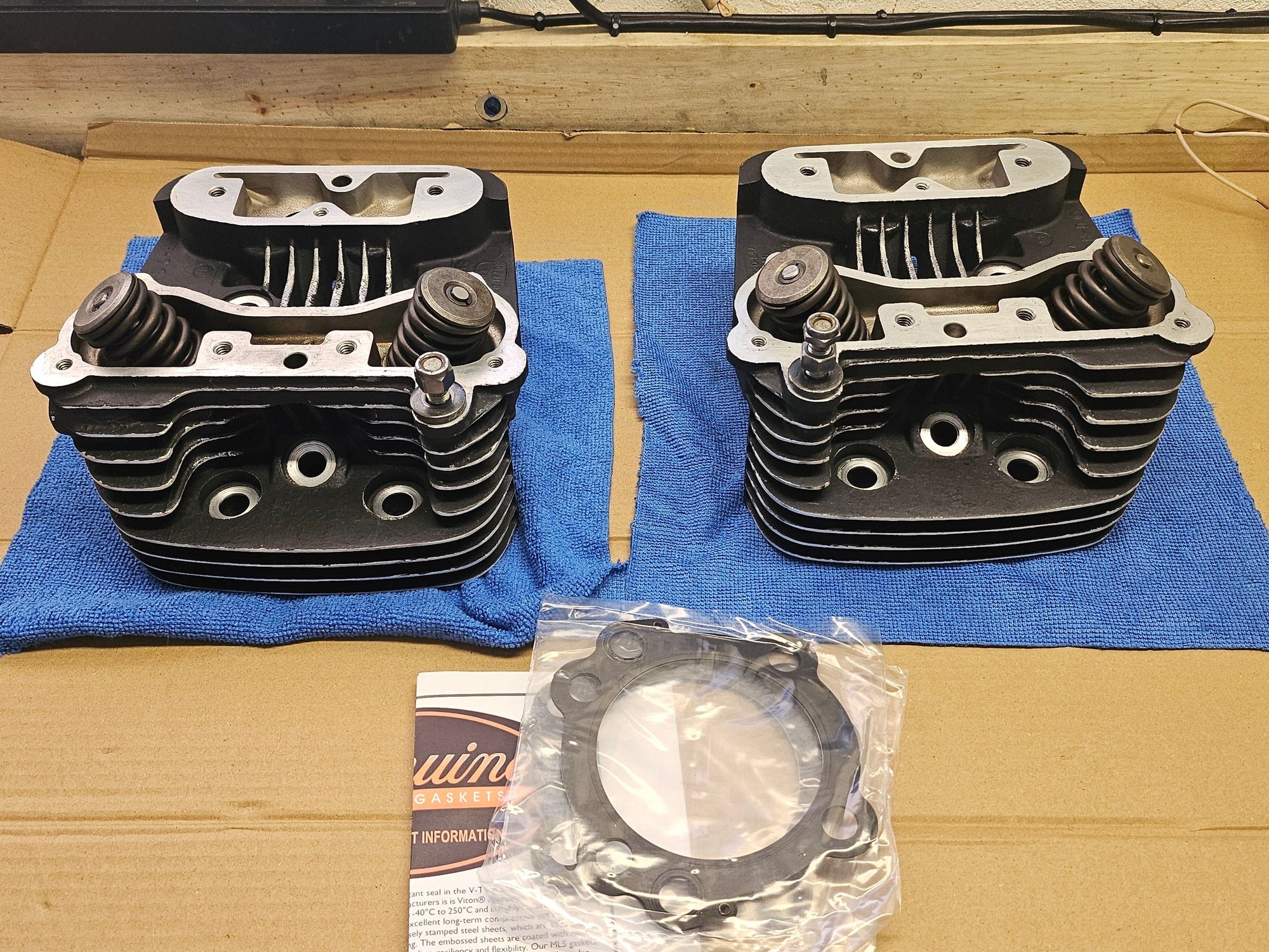

I cleaned and painted the heads, and wiped a couple of hard to get fin areas with paint thinner to make it easier later.
After the paint cured I did the filing and sanding of the fins. These took half the time as the cylinders. The bolt and spark plug counterbores were cleaned up with a wire drill attachment.
I wire wheeled and cleared the head bolts, then oiled up the threads and under the heads. The James gasket kit has MLS head gaskets, so I followed their torque sequence, not the Harley service manual.
