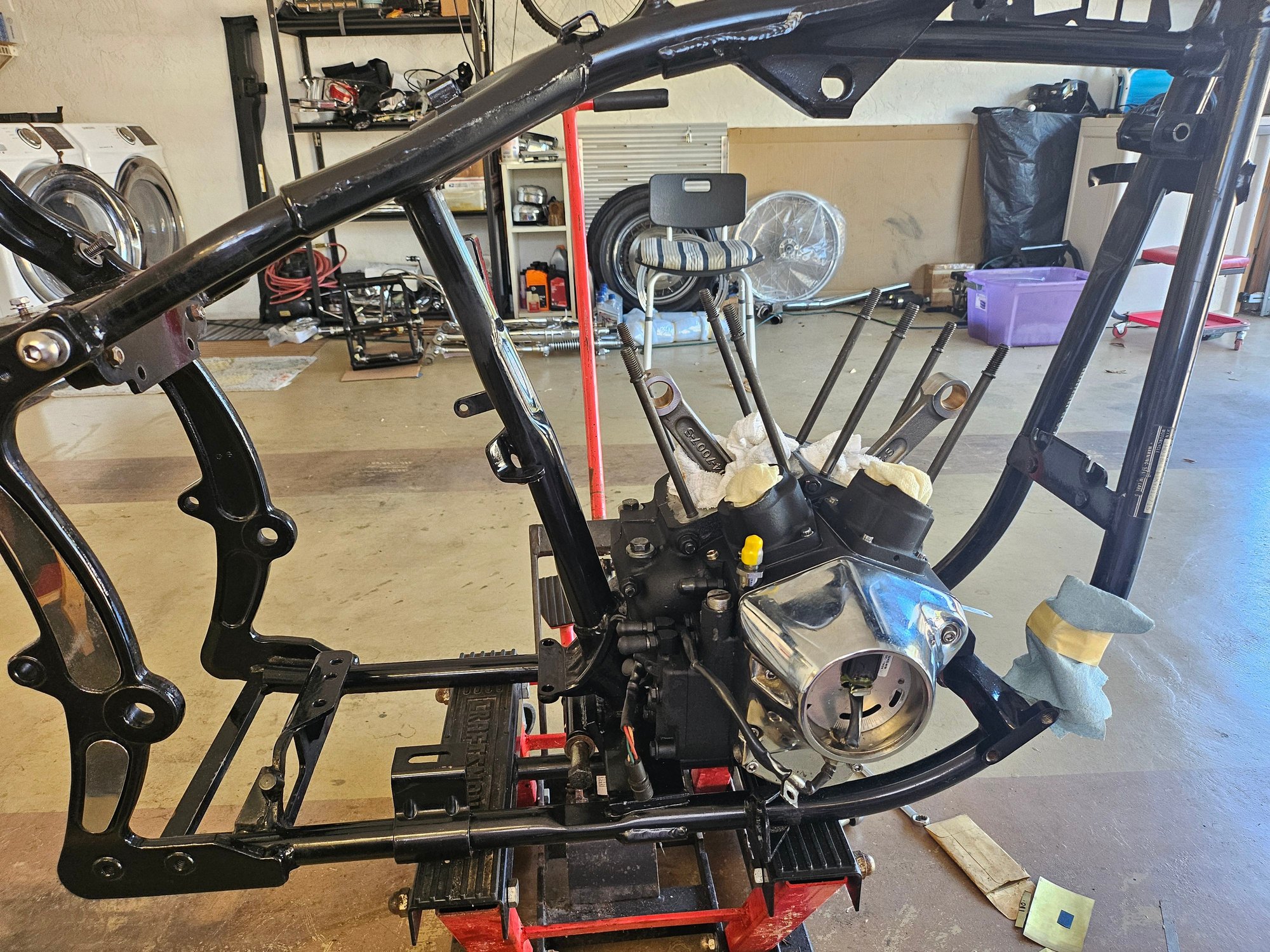

Productive day! The motor is in, and the cylinders cleaned up and painted.

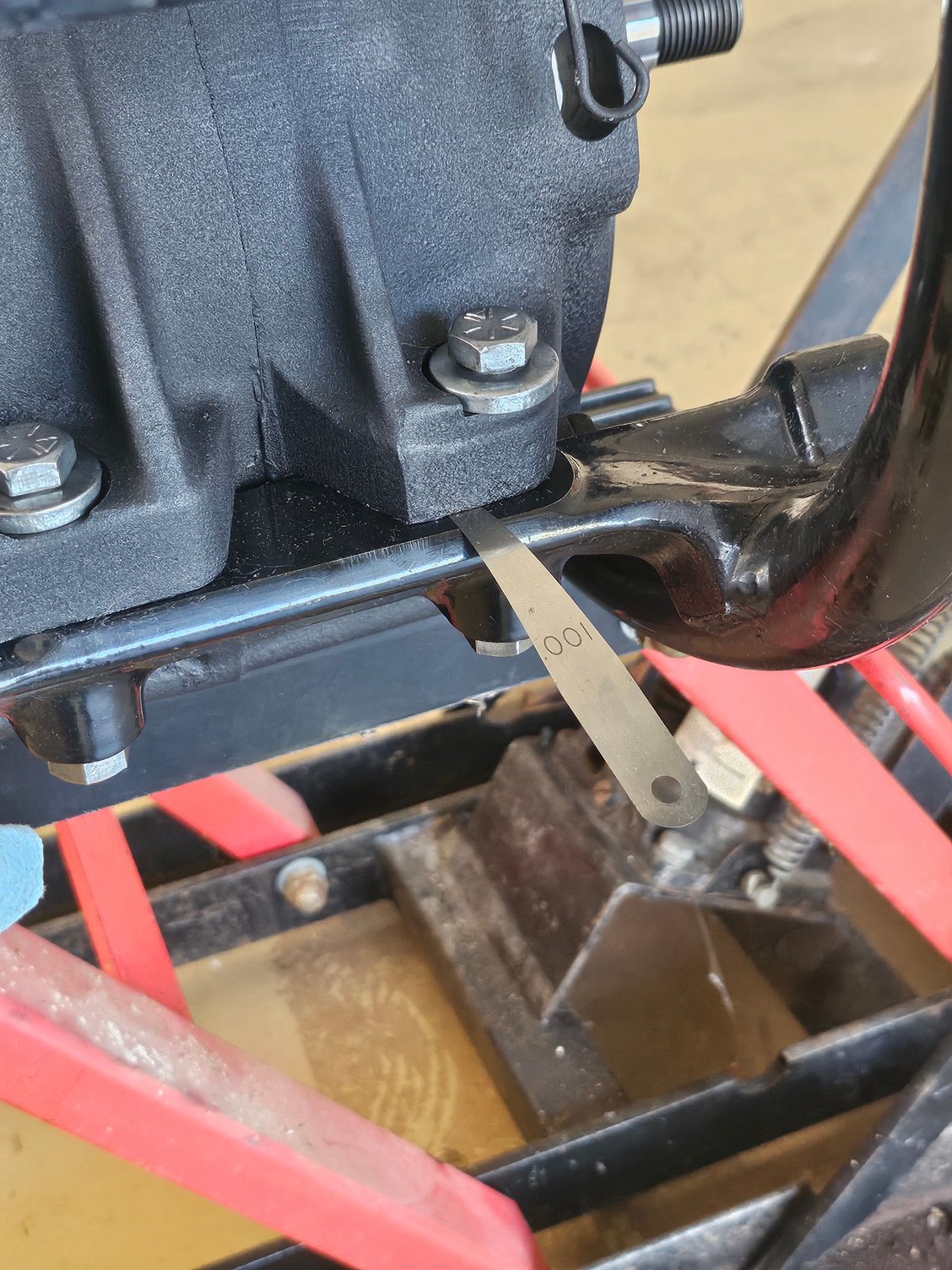

The shop that rebuilt the motor painted the top part of the cases, but I had to paint the bottom half which was inside the stand. It's sitting in the frame now, with all the bolts in but not tight.
The factory did a much better job machining the motor mounting points than they did on my shovelhead. I couldn't fit a 0.001 feeler under either side, with the back bolts tightened. I do this check to prevent loading the case.
The cylinders needed a good cleaning, mineral spirits and a scotchbrite pad on the fins, brakleen, acetone and windex on the cylinder walls. They are only 0.010 over stock.
I'm letting the paint cure overnight, then I'll file the edges of the fins. I'm using HD Texture Black, which is what they used back then. This is different than wrinkle black, if you didn't know.
Tomorrow, if all goes well I'll install the pistons and rings, then slide the cylinders on them.
