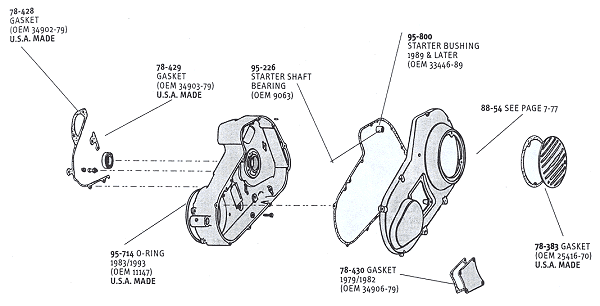

Wrknman-your primary chain inspection cover may not be oval, but you can see the non-round hole in front of primary cover is where you would want to look in and adjust, if you don't want to take off the primary. And you have the parts number to buy the gasket for your bike.
(picture courtesy of Jireh cycles).
