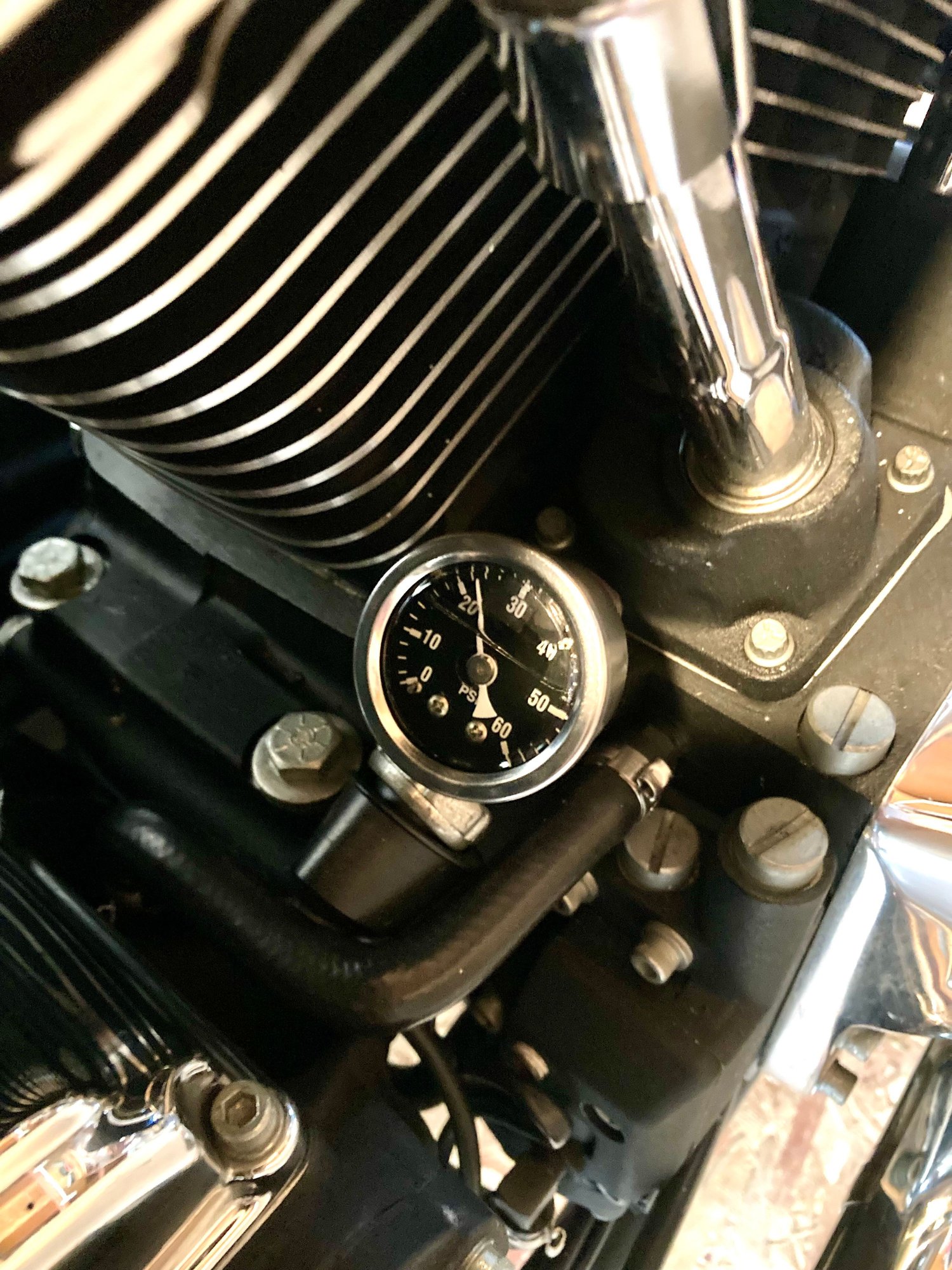

Default I have 22 psi on my 97’ EVO motor
Originally Posted by jurob
i'm looking for an actual number on an accurate gauge. anybody know the spec for low oil pressure at idle when it should go into the shop for a bottom end or whatever?
btw, my pressure is fine.
My old gauge that came on bike when i bought it didn’t work. I bought this gauge recently, it is meant to work on the Harley EVO motor. It says 22 psi. At idle speed.
That's pretty high for idle.. I would imagine somebody probably put a different relief spring in it or something..5-7 is normal at idle 950-1000 rpm....
