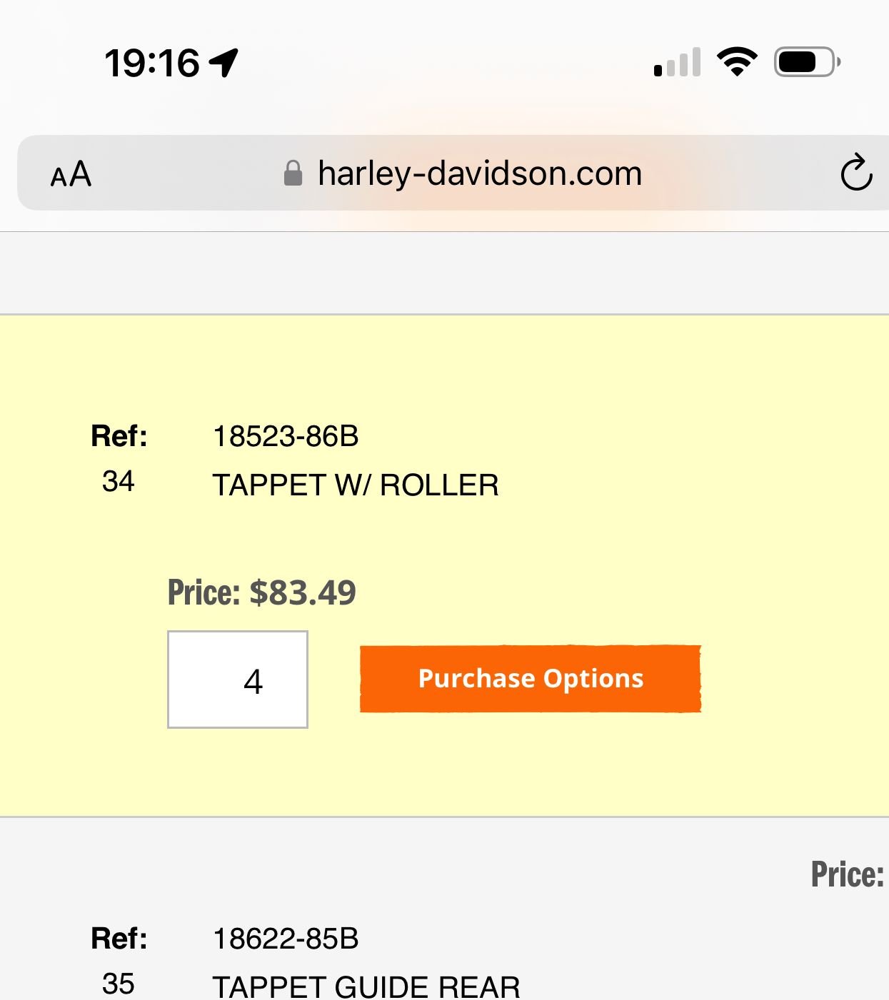

Old Apr 24, 2023 | 09:19 PM
Laowai's Avatar
Laowai
Joined: Jul 2016
Posts: 37
Likes: 10
From: Seattle
Default Belaboring the point:
Harley wants $83.49 per…
Old Apr 25, 2023 | 03:45 AM
Dano523's Avatar
Dano523
Joined: Jan 2020
Posts: 1,434
Likes: 800
From: Colorado
As stared, you can get a set of standard Johnson b2303's for around $180, or the slow leak down versions for $250 from Larry.
Hence at one time, its was Johnson that was making HD lifters, and due to patents when Delphi started making them for Harley instead, had to go to a different design.
As for a decent roller rebuild kit like SS that you could trust the needle bearings and rollers to begin with, your looking at over $120 (f you can find one that fits the body pin channel size), then still have to source the ball and plunger springs to replace them during the rebuilds; that is if you don't have rust or corrosion problems on the lifter plunger or bodies.
So for the price to rebuild a HD evo stock lifter and trust it, your already into the price of just buying the standard Johnson B2303 lifters isntead. As for the old solid lifters, it was just the roller and ball that you have to replace that would wear out, so not comparing apples to apples on those and evo tappets.
As for the oem HD 18622-85B, it's a good lifter that will outlast the older A lifters, but that is a hell of lot of HD badging mark up on a imported lifter to start with.
And one last thing, if the rollers and needle bearing as still in great conditions , then maybe it just time to pull the lifters apart to give them a good petrol cleaning. Hence sludge can build up under the check ball/under the plunger over time, and if the lower check ball is sludge wedged open, lifter is never going to pump up/stay pumped up.
