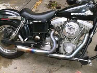

Hello everybody, my name is Matias, I`m from Argentina.
I`ve been reading the forum for a long time, but haven`t introduced myself.
Two years ago I purchased a 1998 FXD, three weeks ago, going to a rally my exhaust cracked 5 inches from the cylinder head, and the exhaust valve get bent.
Really sucked, but it`s the perfect opportunity to get a full custom exhaust and a headwork.
The pictures are with the new exhaust. I will paint the exhaust and the engine with harley black paint.
How much do you recommend to safely shave de heads? remember that for know, the engine will be with everything stock, including cam.
I wll put a new set of piston rings only.
PD: Sorry for my poor english.

Started with the wrong foot, I`ve forgot the pictures.
Attached Thumbnails Hello to all-hpim2751_editada.jpg   Hello to all-hpim2752_editada.jpg

Maybe I`m not saying it right. I mean how much I can mill the heads to raise compression safely.

I'm not sure what years (maybe all) the Evo Police Models had the heads milled .050 (inch) from the factory to raise the compression. You would be totally safe with that.

wow!!
thats much more I expected... do you know how much will raise my CR?
The police models came with the same ignition and carb setup than regular evos?

There are different head gasket thickness avaliable, but with a stock Harley which is .040, it would yield about 9:1 compression ratio. There are some other members who may be able to give you more specific, and better info on all that.
The Police Bikes had the same carb and ignition. They were possibly jetted differently with a different needle in the carb. That would difficult to research, I've never tried. The cams were the "L" grind which is .495 lift rather than the .472 that they all had after 1992. And they were all fuel injected after 1996.

My fear is having too much CR for the original cam, but if the difference with the police model grind is only the lift, shouldn`t have problems with detonation.
That`s what I hope at least.

You should be safe with .050, however you will need adjustable pushrods just to be safe. This would also be a good time to get a three angle valve job, new seals, and have the ports and valve pockets "cleaned up" a bit. Go to nightrider.com, there is a lot of great info there on evo's. Try to find any book ( there are three of them) written by D. Willian Denish on V-Twins the are probably the definitive book on V-Twin performance

i have a evo police model i love it i did change the cam in it and gearing. you will be very happy going with .050 just make sure you jet your carb. i replaced everthing with better parts and was very surprised by the performance
