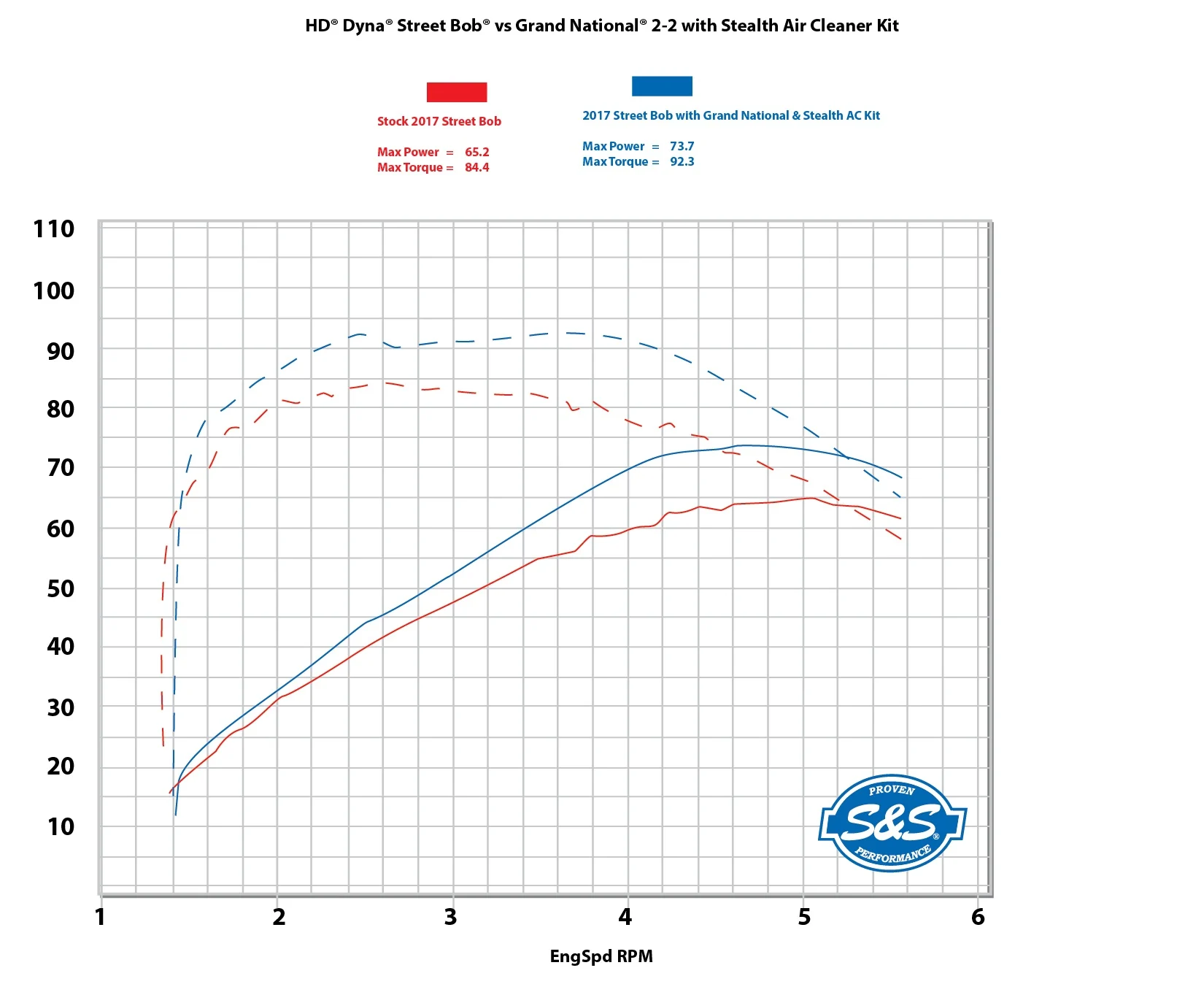

I found a dyno chart on S&S website, for a stock 103" TC:
(with the disclaimer that one should not draw too much conclusions from this, stock cams actually have no overlap so they are not sensitive to reversion at all, so even if the curve looks nice here there could still be a big dip in the mid range on an engine with large overlap cams like mine)
Seems quite equal to stock headers with slip ons on same engine:
