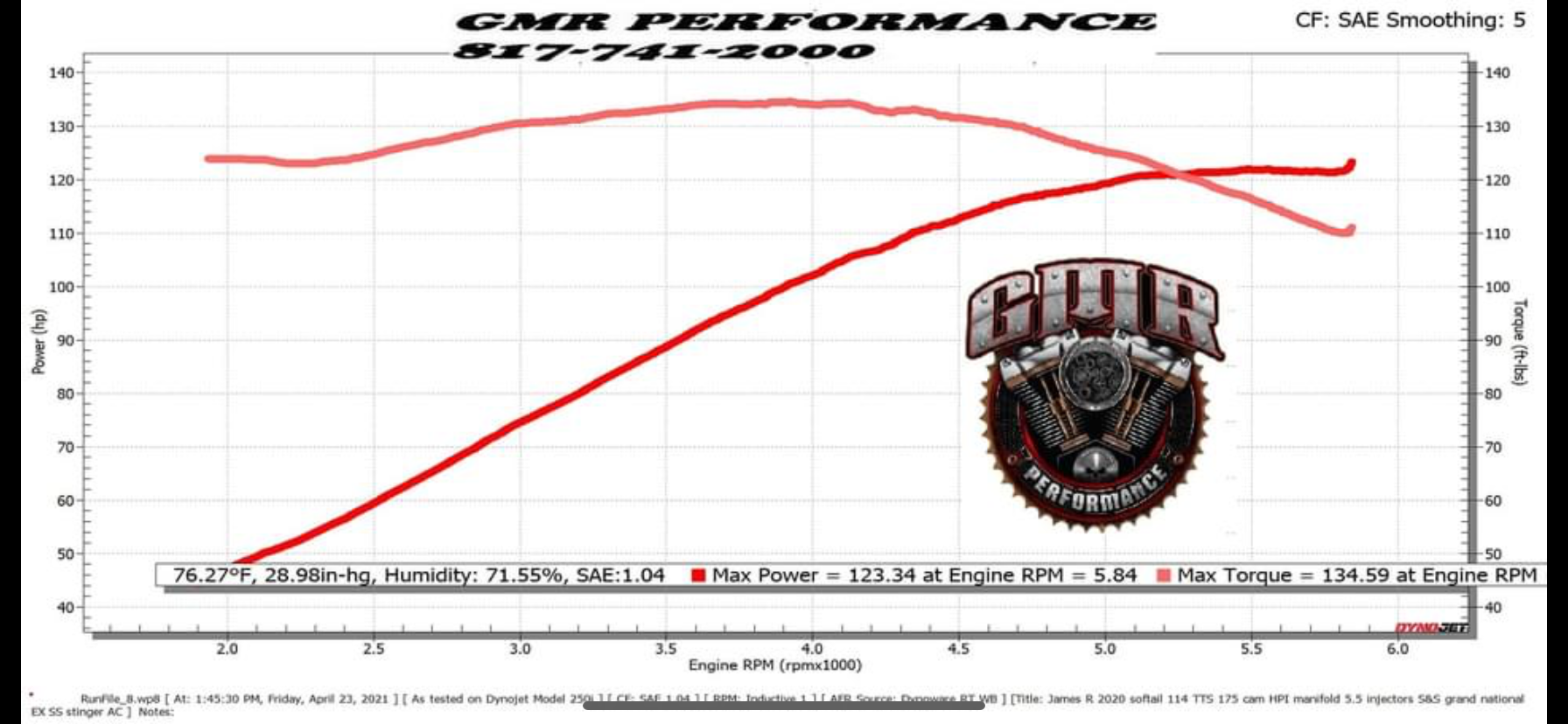

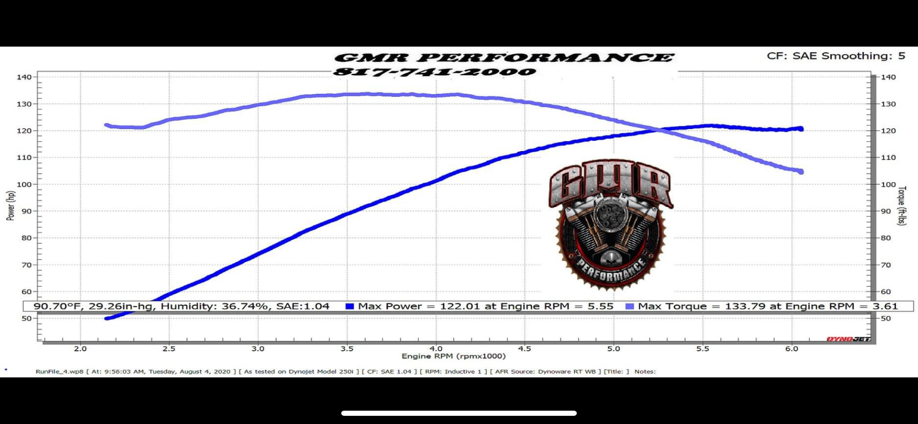

Entirely different engine so not 100% relevant to you but sharing for the hell of it. I remembered seeing these on GMR’s FB page. 114” M8 Softails with TTS 175 cams. Not much to dislike here.
How they will work on a smaller cube motor with 2 valve heads and more overlap, that I don’t know.

Thank you, Im not sure either how relevant it is, but still nice to see them perform well in one configuration
