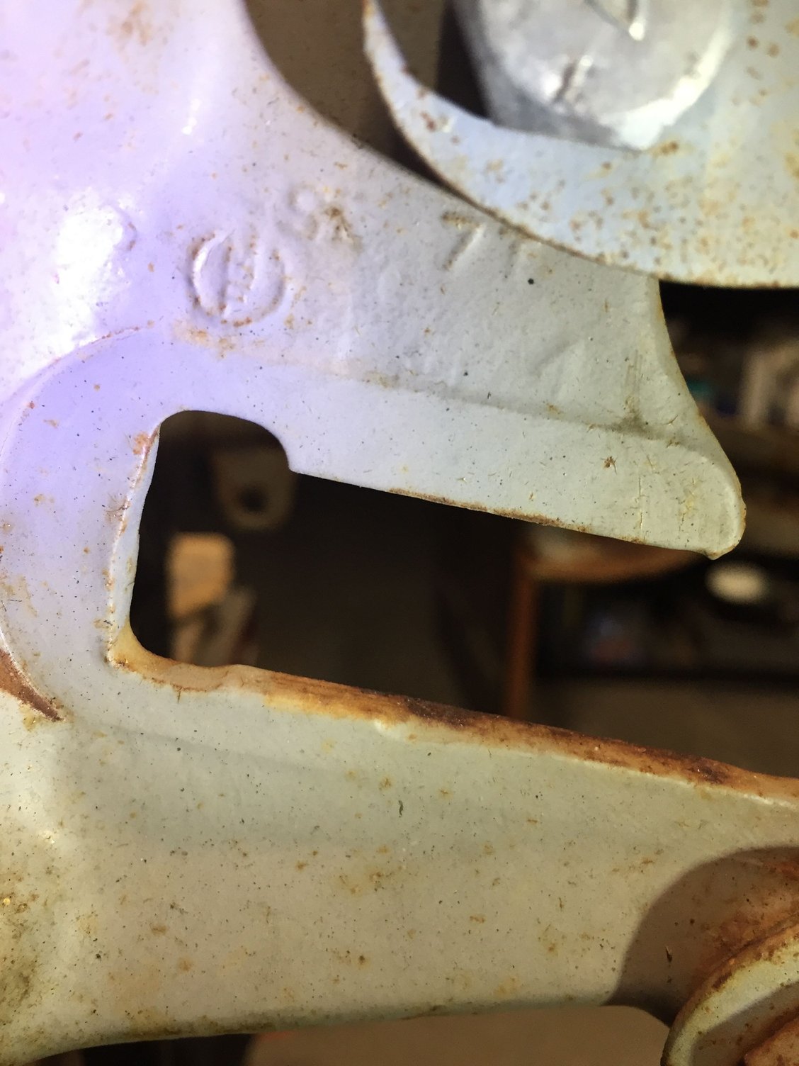

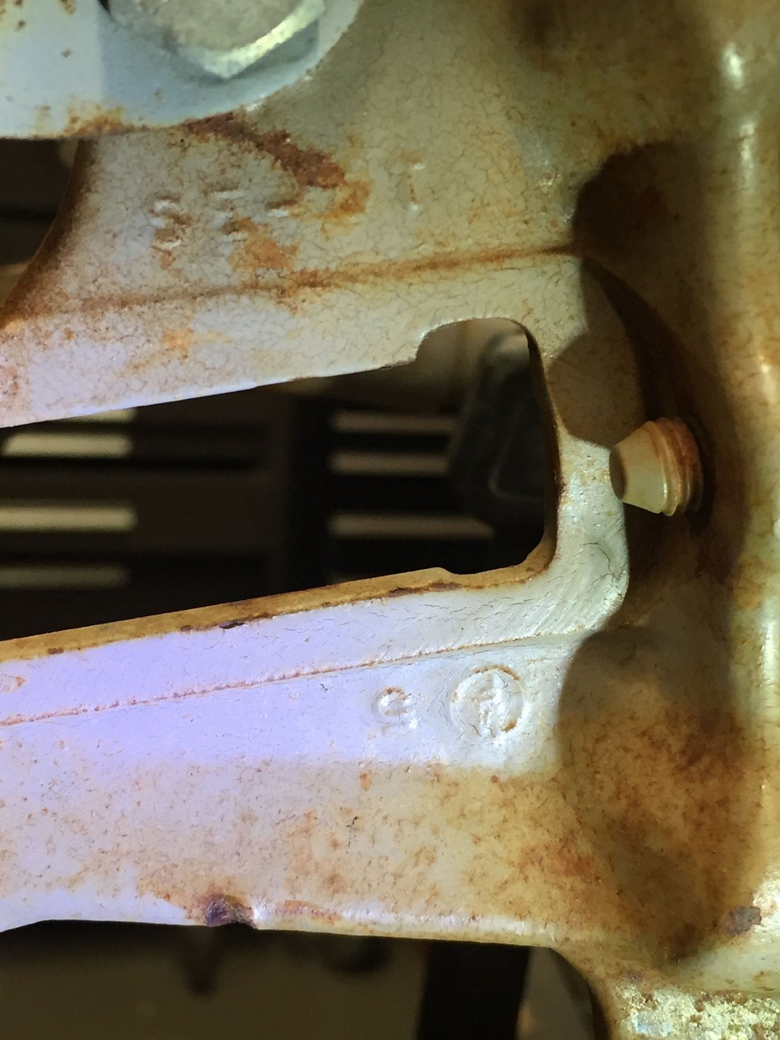

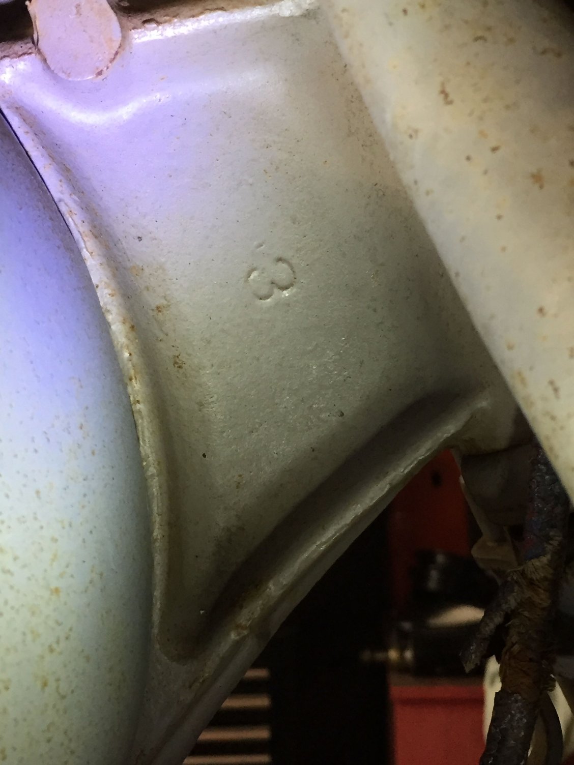

Frame pictures:

Frame may be a 1943 model. Left side of steering head has forging number ZE-35T. Forging hallmark looks like A (?) and that type of hallmark is sometimes referred to as 'A in a jar'. It represents AmForge, Chicago, Illinois. Die number looks like 8 and helps indicate a 1943 steering head according to Bruce Palmer’s resto book. (Also used for 1943 were die numbers 7, 9 and 10.)
R-H side of the steering head appears to have the number 3 but I don’t know what it indicates.
Left axle clip has forging hallmark M over F in a circle indicating Modern Drop Forge in Illinois. Forging number is SE-7T. Die number looks like 4? If so it indicates 1942–43.
R-H axle clip has forging hallmark M over F in a circle (upside down) indicating Modern Drop Forge in Illinois. I can’t read the entire forging number but I imagine it is SE-6T? Die number looks upside down and it may be 5? If so it indicates 1943–44.

You're welcome Terry. I agree the engine and frame are not original to each other. As mentioned in your other thread, many engines were not stamped with a serial number and that may be one of them.
