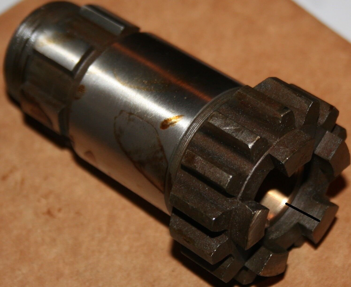

If anybody has a clutch gear sitting around, please measure the bushing recess. I am measuring from the top of a tooth down into the bore to the bushing. I attached a picture with a line drawn to illustrate the measurement. The old gear was .350" and the new gear was .410, so that is a .060 difference between the two. That .060 is what adds to the end play..
I would hate to buy another clutch gear, as this one looks good otherwise and I'm happy with the fit in the left side big race.
