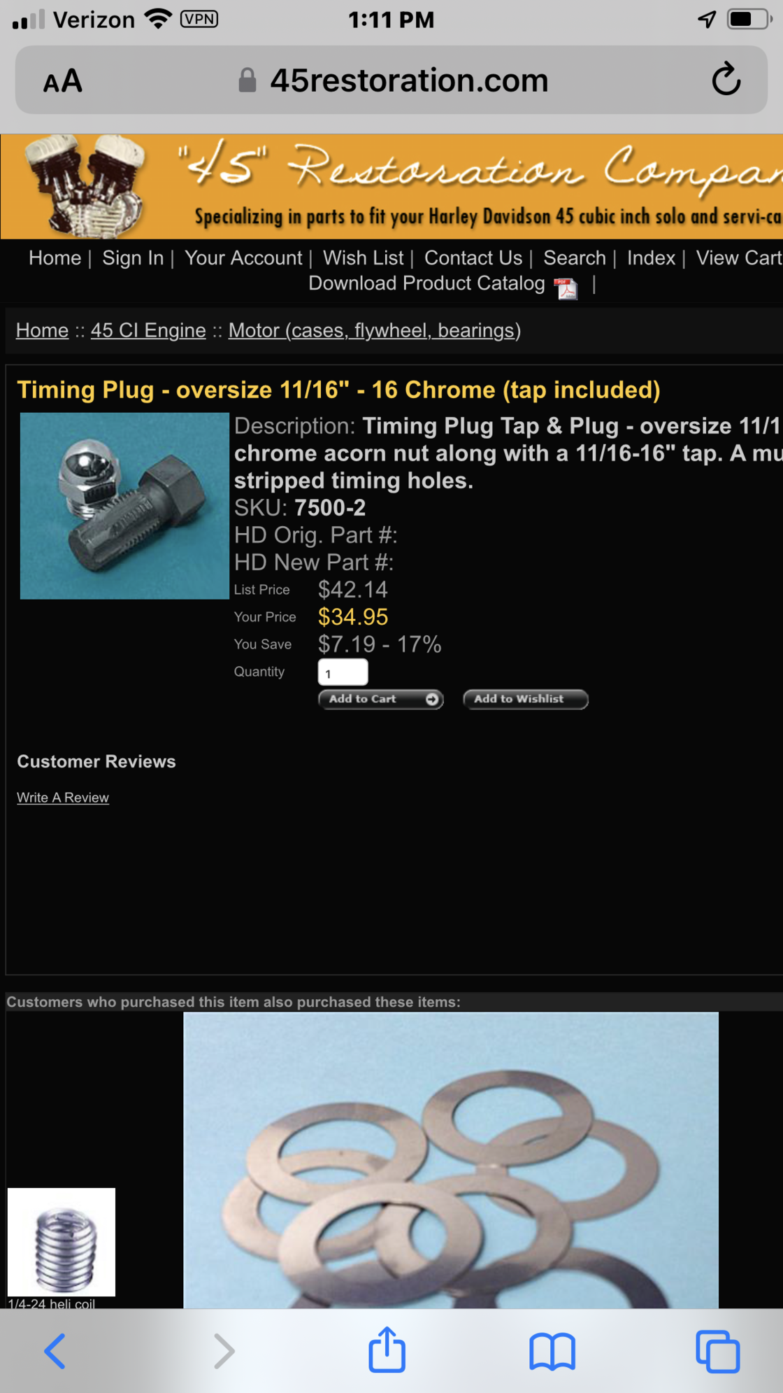

I see that 45 restoration company has a 11/16 tap with a new chrome plug, to fix stripped out plug hole.
Has anyone out there done this is ? And if so did it work out?
Im kind of concerned about alum shaving being pushed inside of the motor.
Scottie p

The BEST solution is to tear it down and weld it like johnzzzz mentioned.
As Architect mentioned above, you can tap the new threads using a larger tap with lots of grease on it.
The grease is supposed to catch the metal chips and keep them from falling into the crankcase.
This technique works pretty well for tapping new spark plug threads on a flat 6 Porsche 911 engine,
In that case, the cylinders are horizontal and you can vacuum the bulk of the chips out.
Does it work well for a WL? I'm guessing 50/50 chance.
Are the threads THAT bad?
Could you use the normal size tap with grease on it to clean up what threads you have?
LESS chips to worry about. You could also use pipe thread tape to tighten the connection.
Good Luck!

I would say there’s about 20%threads left.
I did try wrapping it with pipe thread tape but it works so so ! with little effort it still will turn, and the way these old boy vibrate its something I don’t want to fall out.
I guess I know what the answer is being a perfectionist!!! Take it apart and weld and tap … you only cry once
Thanks.
