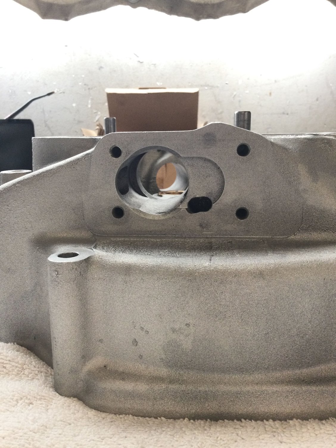

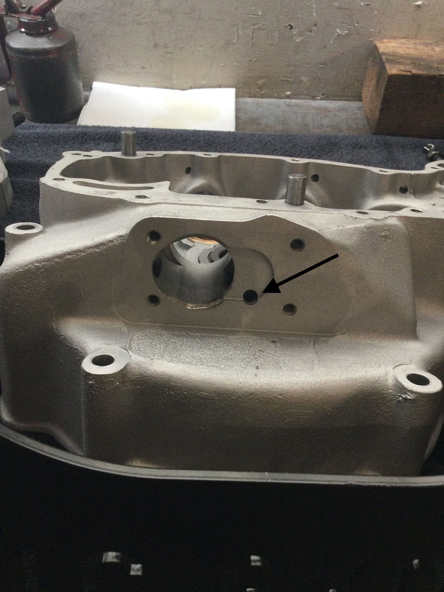

I modified the oil channel from the cam crest to help the scavenging of the CHP pump, I
made a paper template off the oil pump and opened up the case to match the pump.
Carl at CHP suggested doing this to increase scavenging.
before
After
