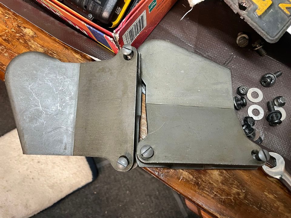

Any body know how and where these are attached?

I believe they attached to the back of the half moon footboards with the dome facing out from the bike.

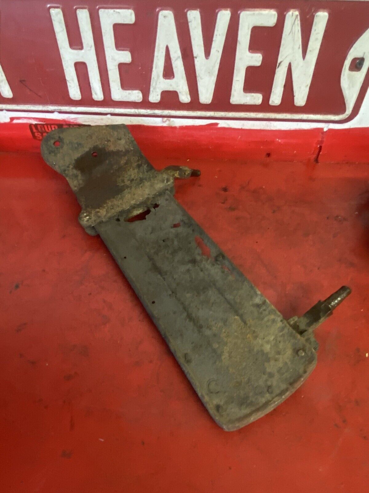

I thought they were for the earlier rectangle foot boards.

Crap! I have the half moon boards.

I am pretty sure those foot board extension will also fit half moon boards. Clamp on to the back of the board.
