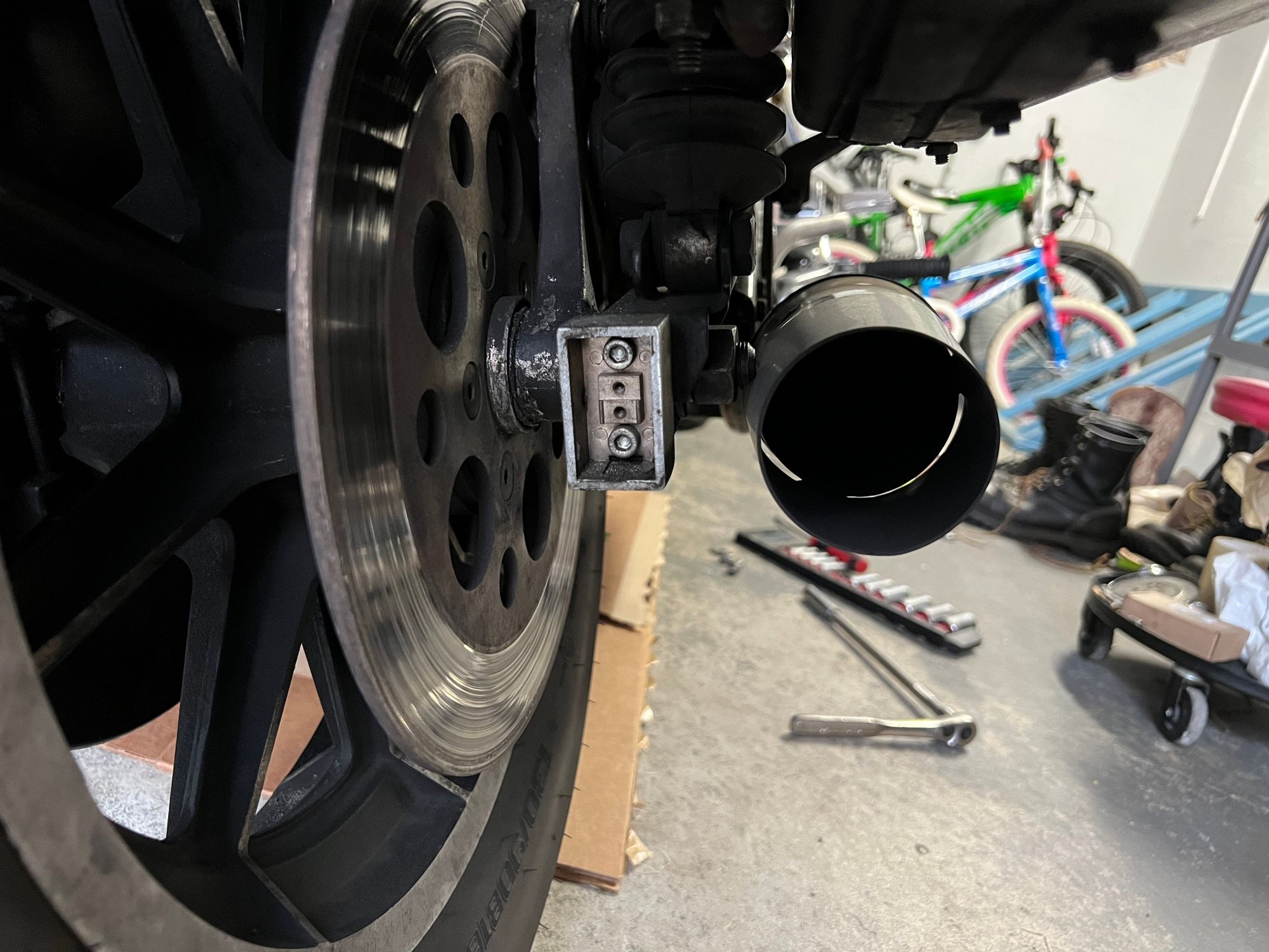

Last night, I yanked the thunderheader off my 94 and put it on my 84. It didn’t quite fit.
this bike is pretty tall. I like that about it. I’ve noticed that places that sell thunderheaders list 84-86 and 87-94. What is the difference in those two? Is the early pipe angled outward more?
I’ve noticed some differences in the two before. My 94 seems to have the drivetrain further to the right than the 84 does or maybe it’s more narrow. Both of those seem unlikely to me, though. I have another pipe I wanted to try, but it has a transmission mount and would take quite a bit of modification to fit. Is the transmission case different?

Frame dimensions are the same. Difference is in the exhaust mounting tabs. OP should use some washers/spacers to angle out the exhaust pipe slightly and call it a day. TH's are the coolest of the cool but I've mounted 4-5 on different bikes over the years and they all fit slightly different.
