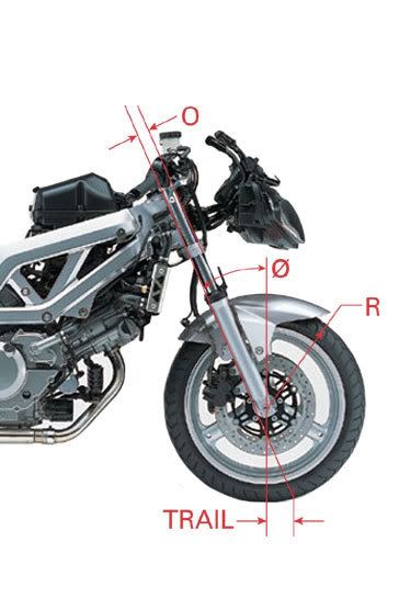

Good pic Gutman; here's another:

Originally Posted by Trock
If you draw two lines one straight down the forks to the ground and one straight down from the axle the distance between those 2 points is the trail.
No. Draw a line straight down the steering head to the ground, and the other straight down from the axle as you stated - sharkey's picture illustrates it well. The fork tubes will always be offset from the head and give an inaccurate reading... even more so with raked triple trees.
Correct, use the actual centerline of the shaft/pin/bolt. to where it intersects the ground.

In this photo the trail distances are shown both in metric & US standard format...
