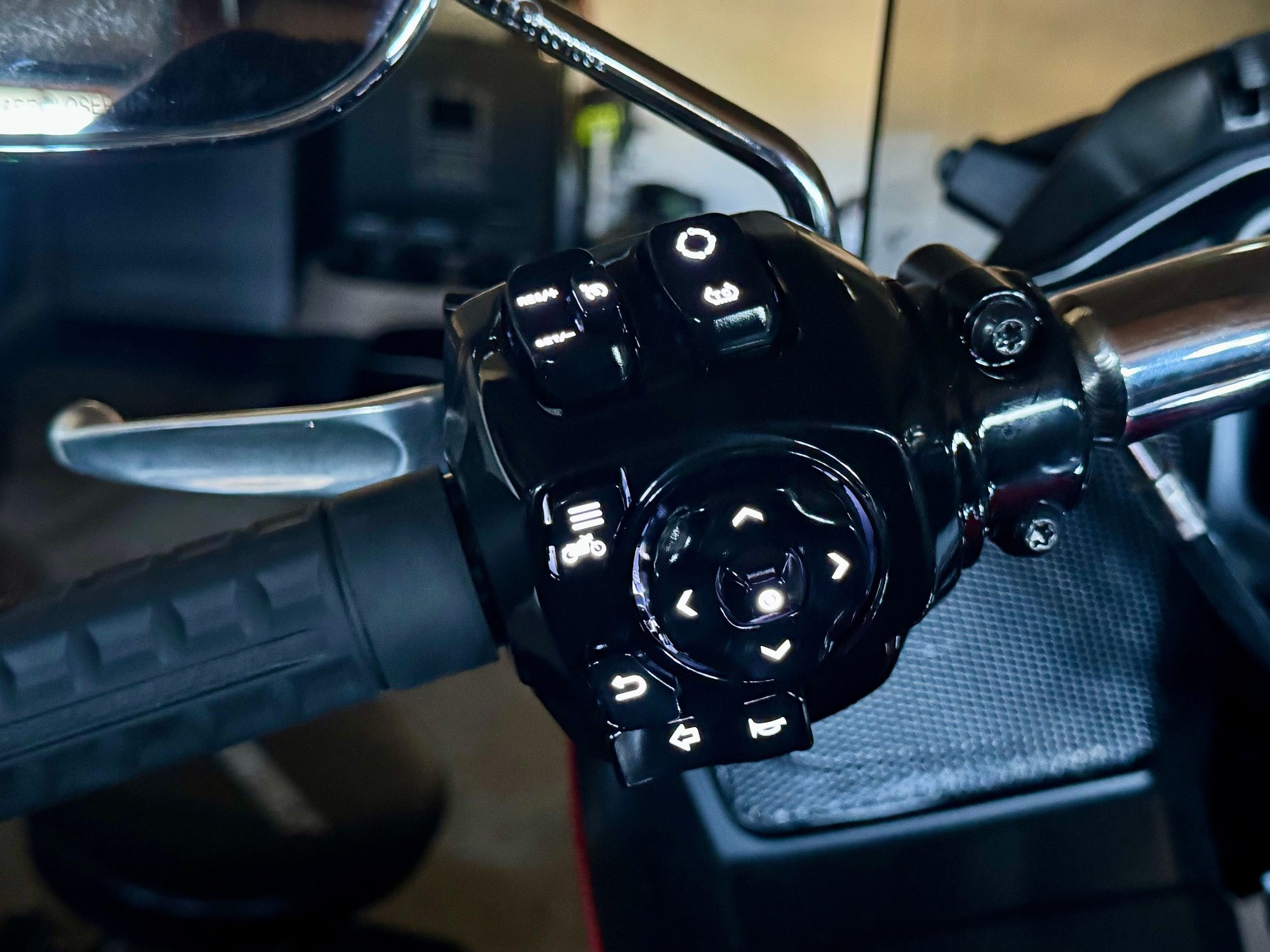

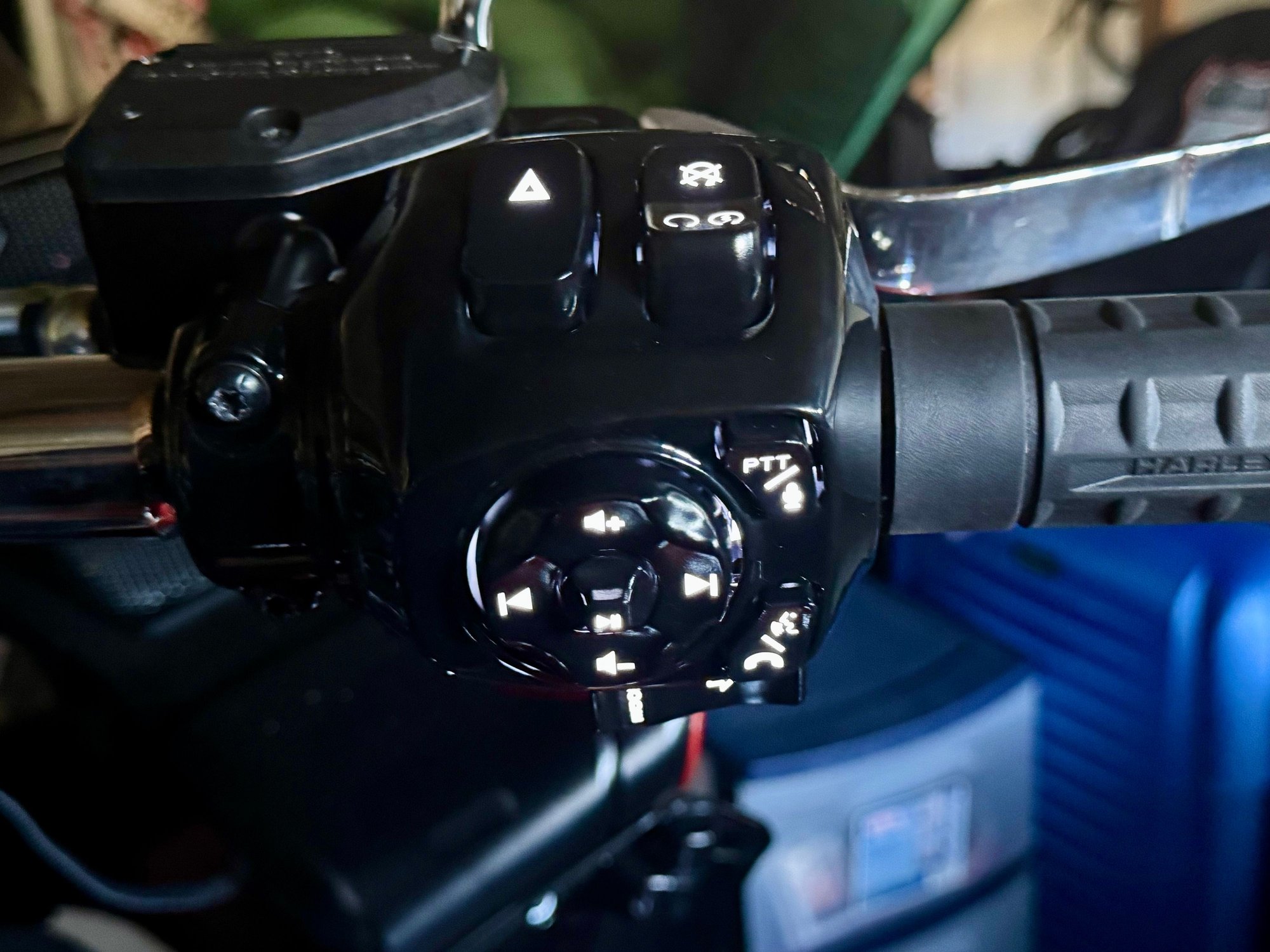

Just put these on last night 20 minutes of time, about…just make sure you are careful jump starting..i plan on keeping left controlled on bike, non lit, controllers around just in case you need to take off in a pinch..
