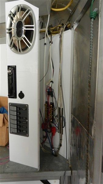

You got to have a main control switch panel & front speakers.

Soffeting to hide wiring & mount LED & florescent lighting & rear speakers.
Installed a pair Amps (1 sub)
