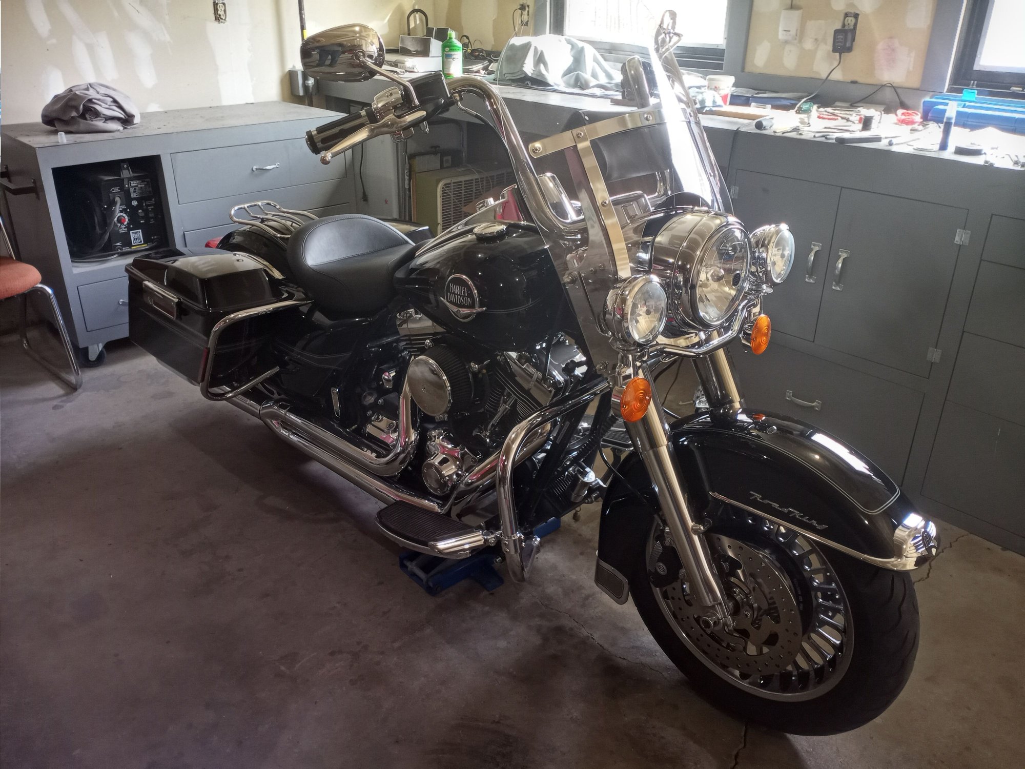

Funny , after I posted this , I had a deja vu moment , thought I posted this somewhere in here . I actually used electrical tape and wrapped that connector tightly , but something in the back of my mind said , " don't do it " . I had to install a longer brake line , so I had to wait a bit before putting it back together , but finally got it done , ready to ride .

Nice job brother! And saved yourself boat loads in labor costs.

Thank-you ! Yes , that's the only way I could have gotten all this done , comp , cams , exhaust and bars . I made a decision to get the bike done exactly the way I wanted it this year , nothing more . The service and electrical manual came in handy on more than one occasion , definitely paid for itself .
