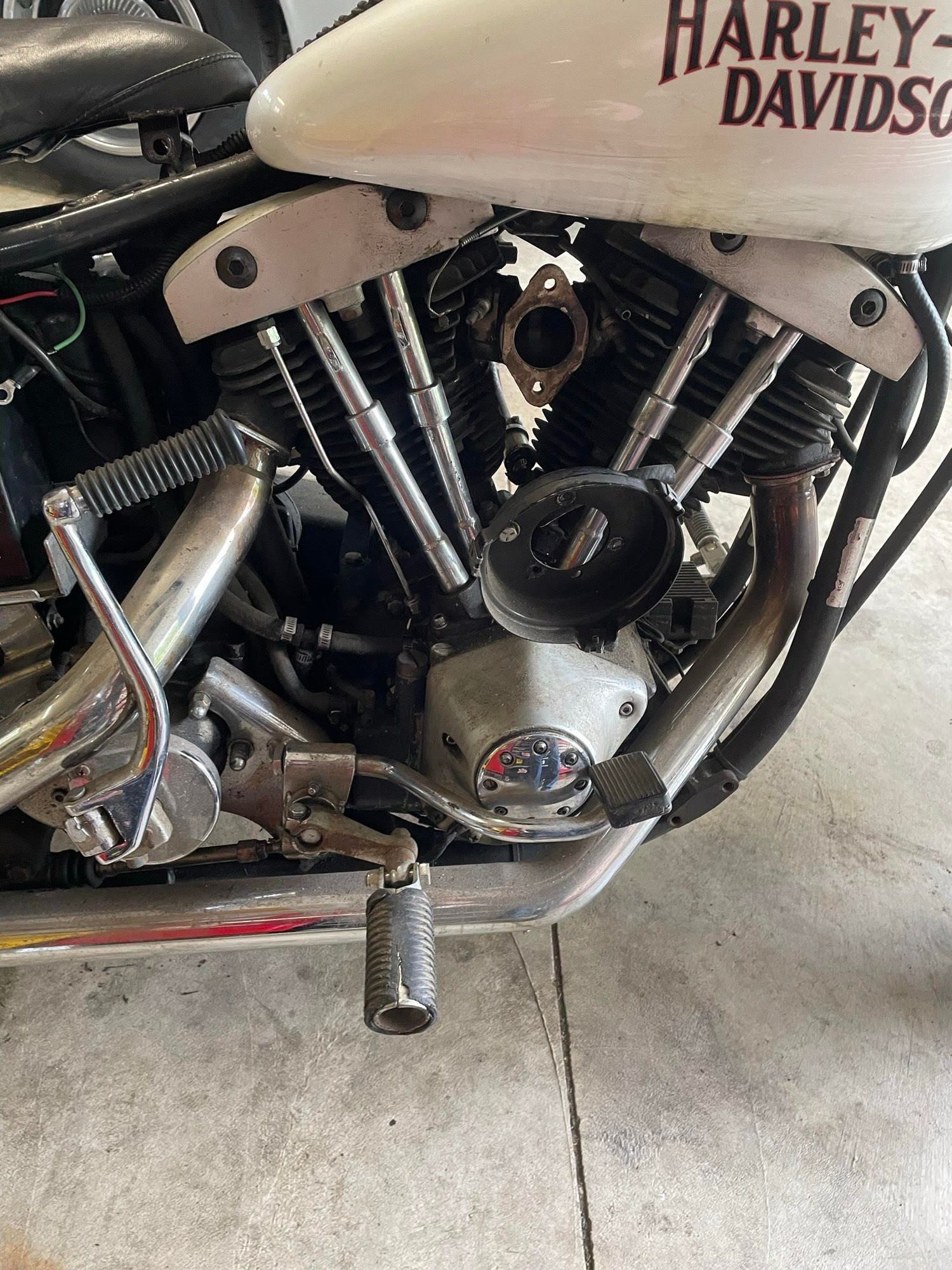

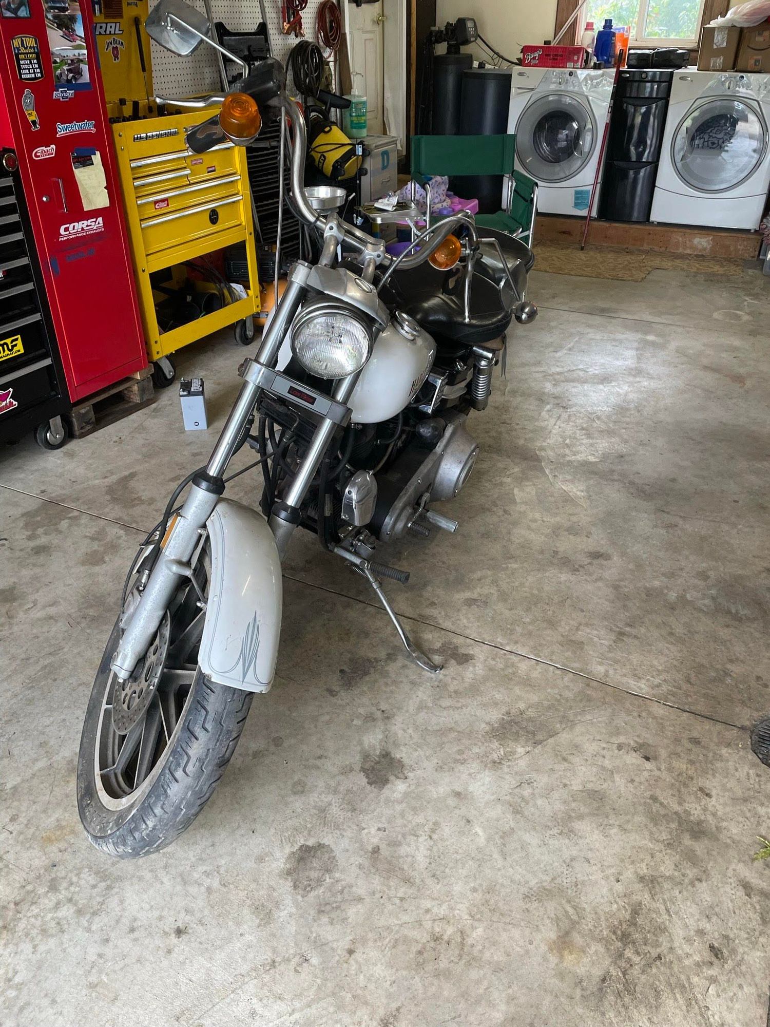

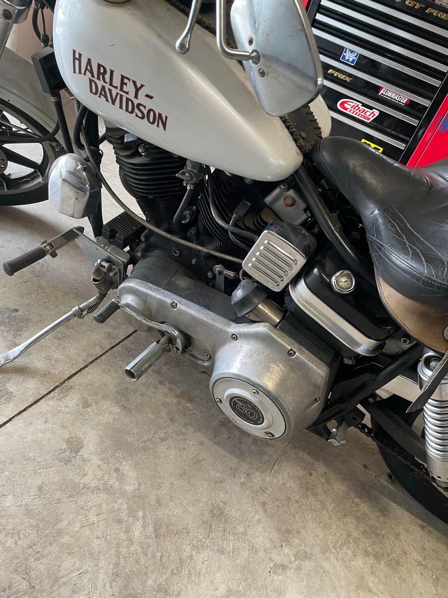

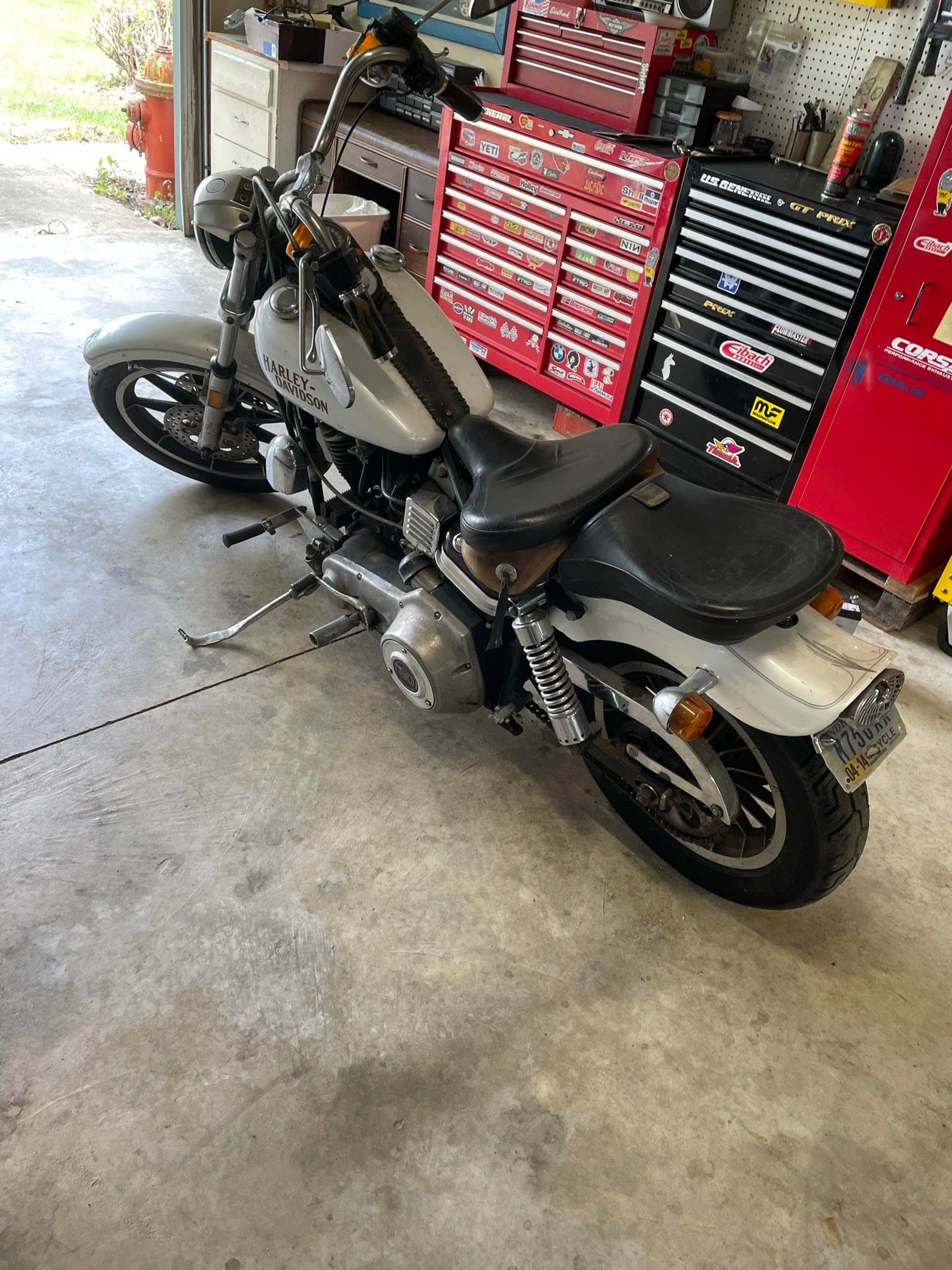

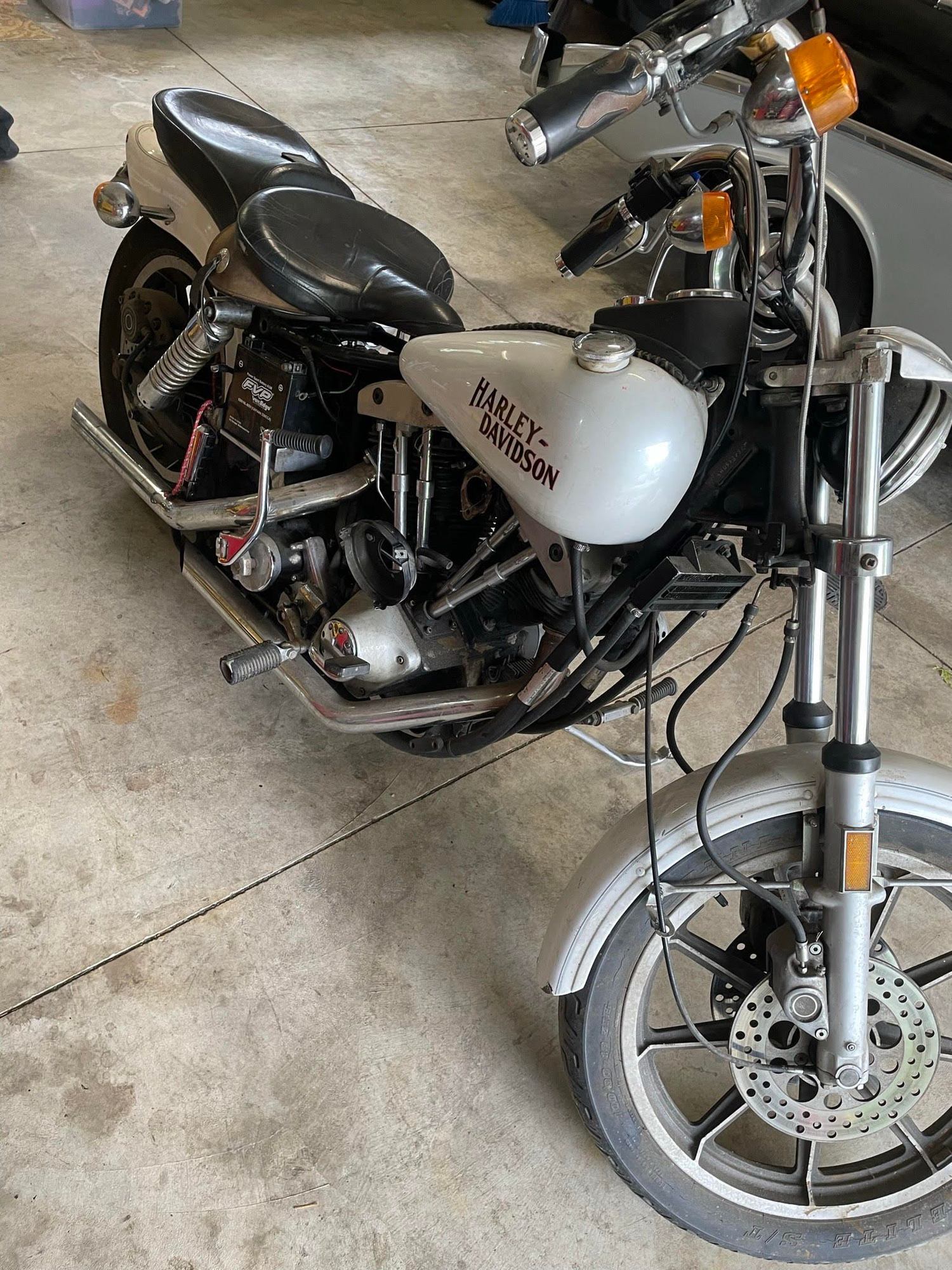

Here's some photos once i got it back in my garage

i hope that intake was blanked off during storage or you may have other problems.
