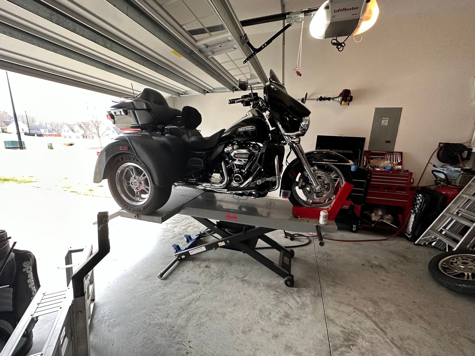

I have a Handy and a Black Widow. I like the smooth deck on the Handy vs the tread plate on the Black Widow. My Handy is old and built from heavier materials.

I've honestly never had any problems with it, so never had a need to get parts. I put a few drops of air tool oil in the hose every few months when I remember, and I've hit the wheels with some oil a few times over the years. That is the only maintenance it has needed.
