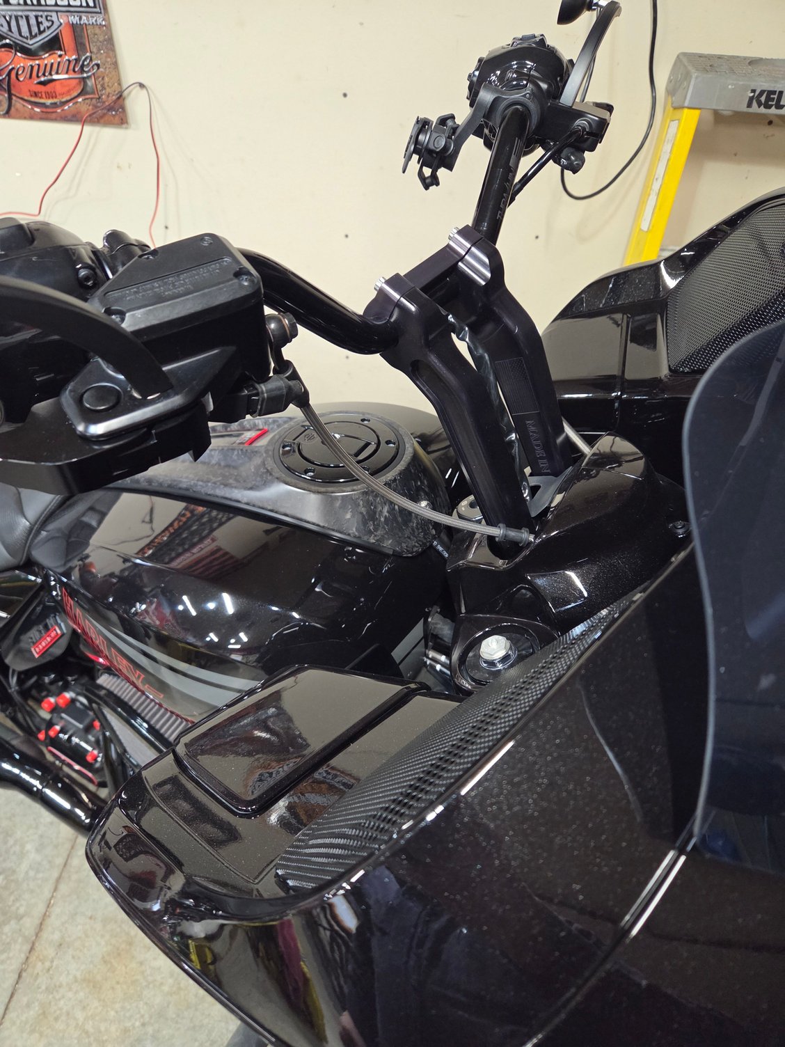

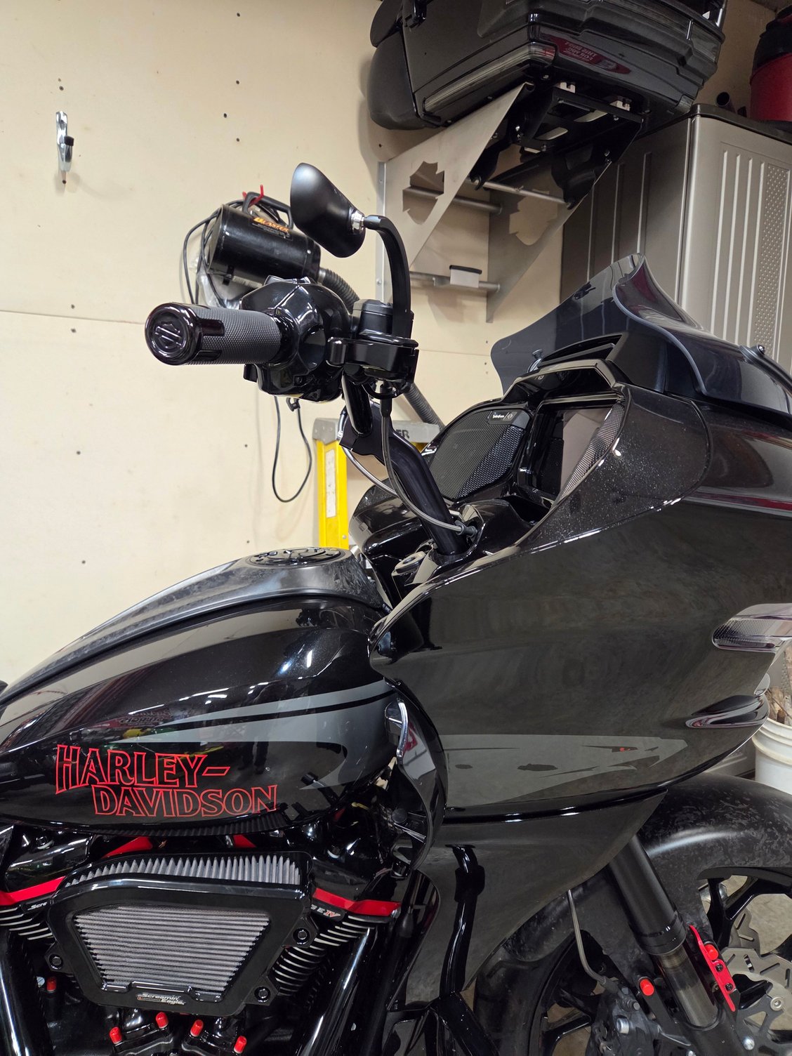

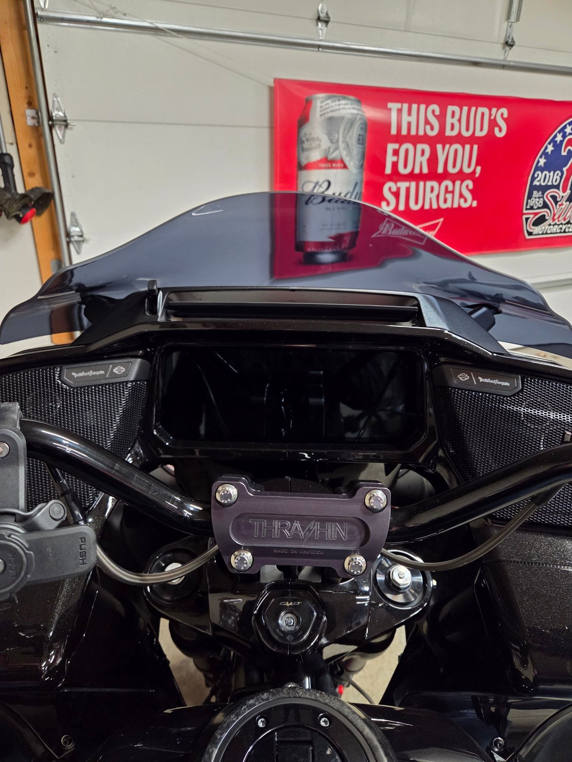

Can you post a pic so I can see how they look, I'm thinking of going that route from 12" apes. Any problem seeing the infotainment?

I will post some pics tonight if I remember. No issues seeing the screen.

Last pic is from the seated position. I can see the screen just fine.
How did you route the clutch cable? I installed the KST Pathfinders and it seemed at it's limit.
Pics of the routing would help if you have them.
Thanks!
