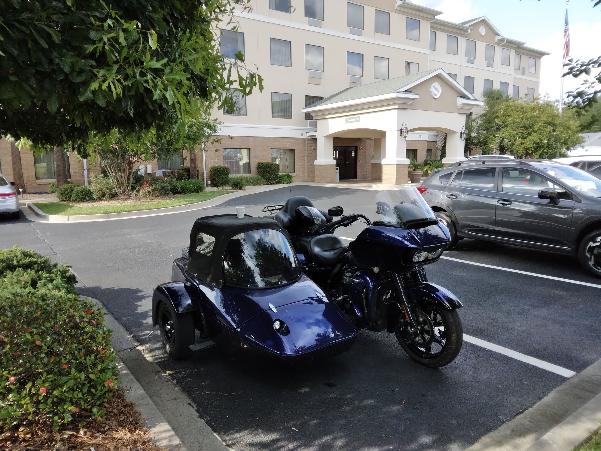

Second bike this Sidecar has been on it has 75,000 miles on it . Many more to come.
