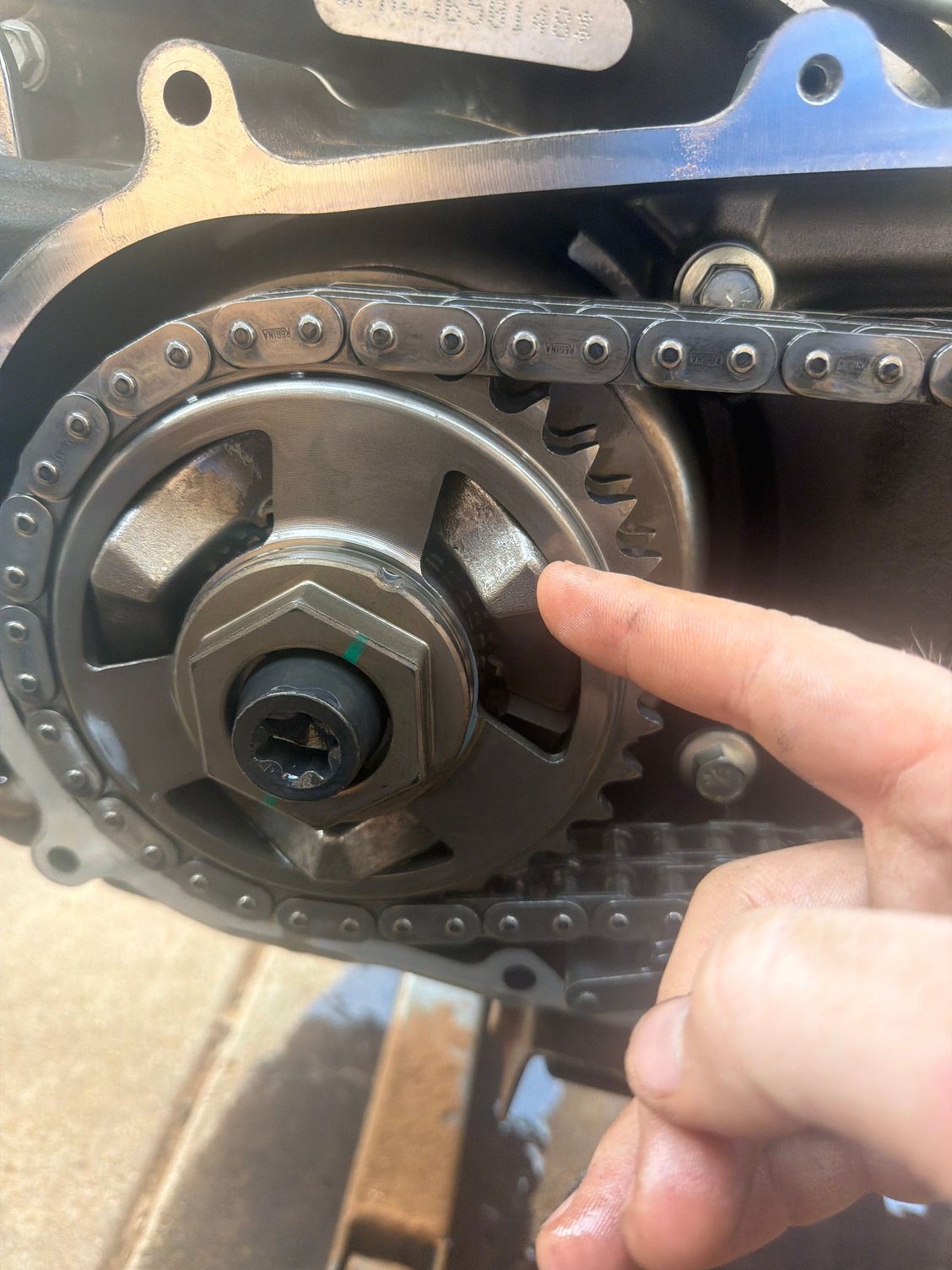

Old Mar 18, 2026 | 07:09 PM
Jimmy Rogers 0987654321's Avatar
Stage III
Joined: Mar 2026
Posts: 3
From: New mexico
Pull the outer primary cover and check the torque on the compensator bolt.
found this broken gear But not sure what is is called
Old Mar 18, 2026 | 07:12 PM
MURPHCC1's Avatar
MURPHCC1
Joined: Apr 2013
Posts: 5,722
Likes: 3,714
From: Cape Cod
Thats the Compensator.
Get the rear wheel off the floor, put it in gear and rotate the rear tire and see what the compensator does.
