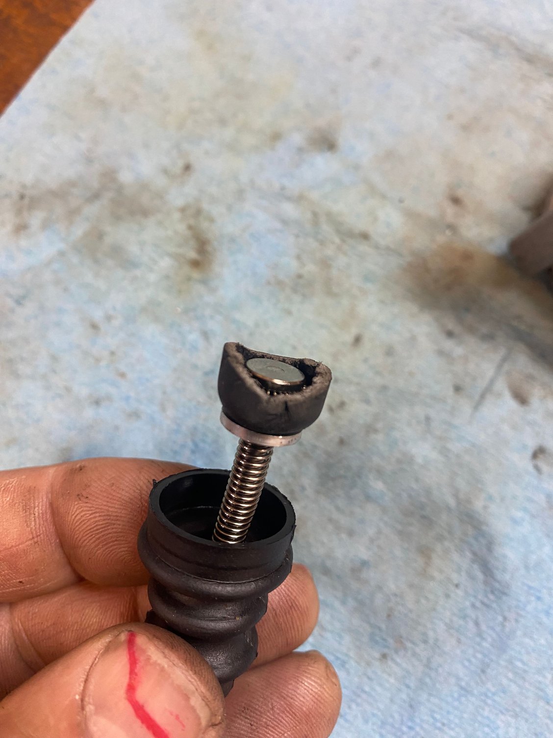

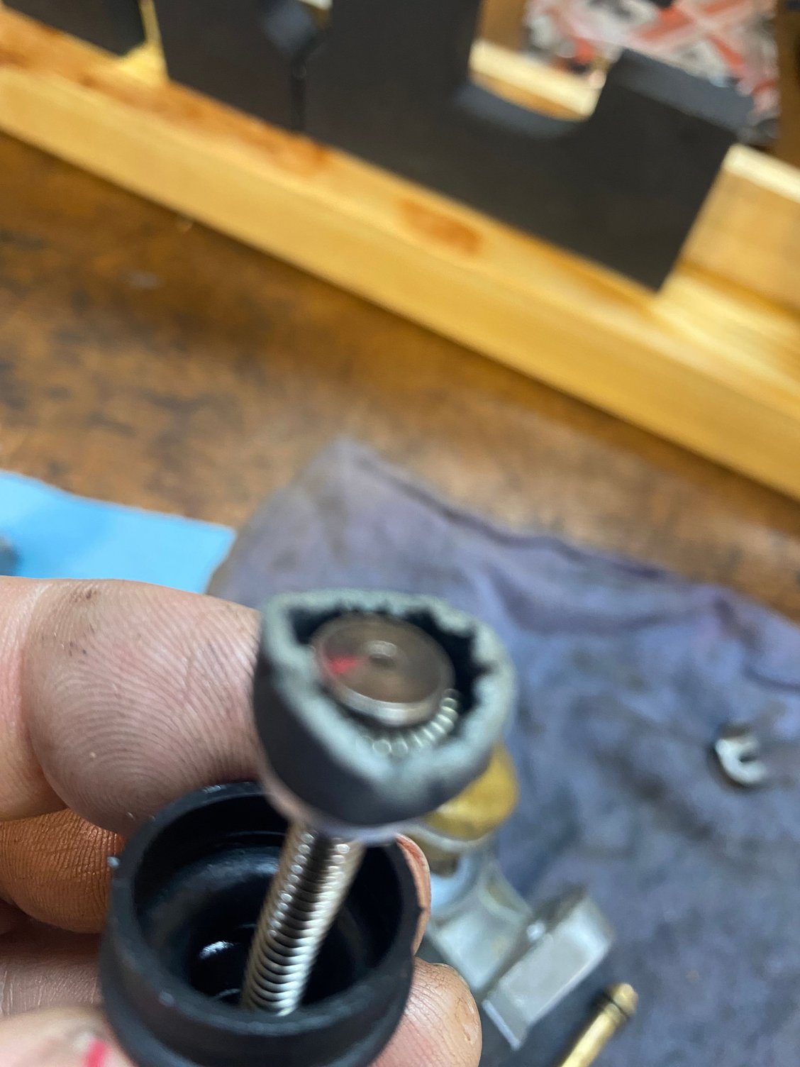

Think I found the problem, or a problem anyway.

I don't use the squirter on any of My Ironheads.. Don't need it if tuned correctly...no reason to Throttle jockey..stabbing the throttle accomplishes Nothing!! and Do Not Idle so Low..
Edit to rescind the "any". There is an old Ironhead here, that is Tired, mostly Bone Stock. It needs to be quite Rich, plus a small Squirt, to act proper! So...If you try to replace that "packing" get the real one from Facet Fuel/Zenith

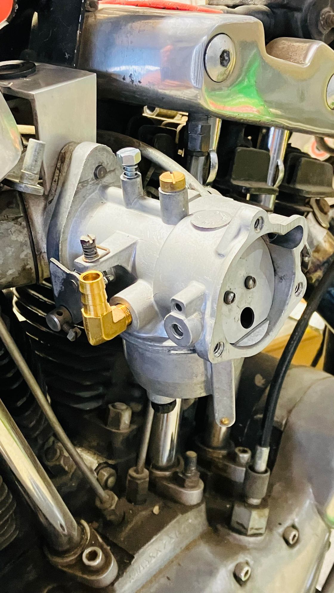

I've had a fairly clean XLCH project for a couple of years now. Had the stock Bendix ultrasonic cleaned and kitted with OEM parts; also changed o-rings and fitted a new support bracket made of angle aluminum. Runs like a top! Smooth starts and relatively smooth engine up to 75 mph. I credit the proper cleaning, rebuild and setup to a gray haired HD mechanic friend; I hand fitted the support bracket and o-rings myself.
