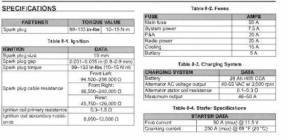

Old Sep 9, 2020 | 11:17 AM
Grullo's Avatar
Grullo
Joined: Apr 2017
Posts: 29
Likes: 30
From: Killarney, Manitoba
Old Sep 10, 2020 | 10:05 AM
Glock-45's Avatar
Glock-45
Joined: Jul 2018
Posts: 74
Likes: 10
From: Miami
Thanks for the info.
