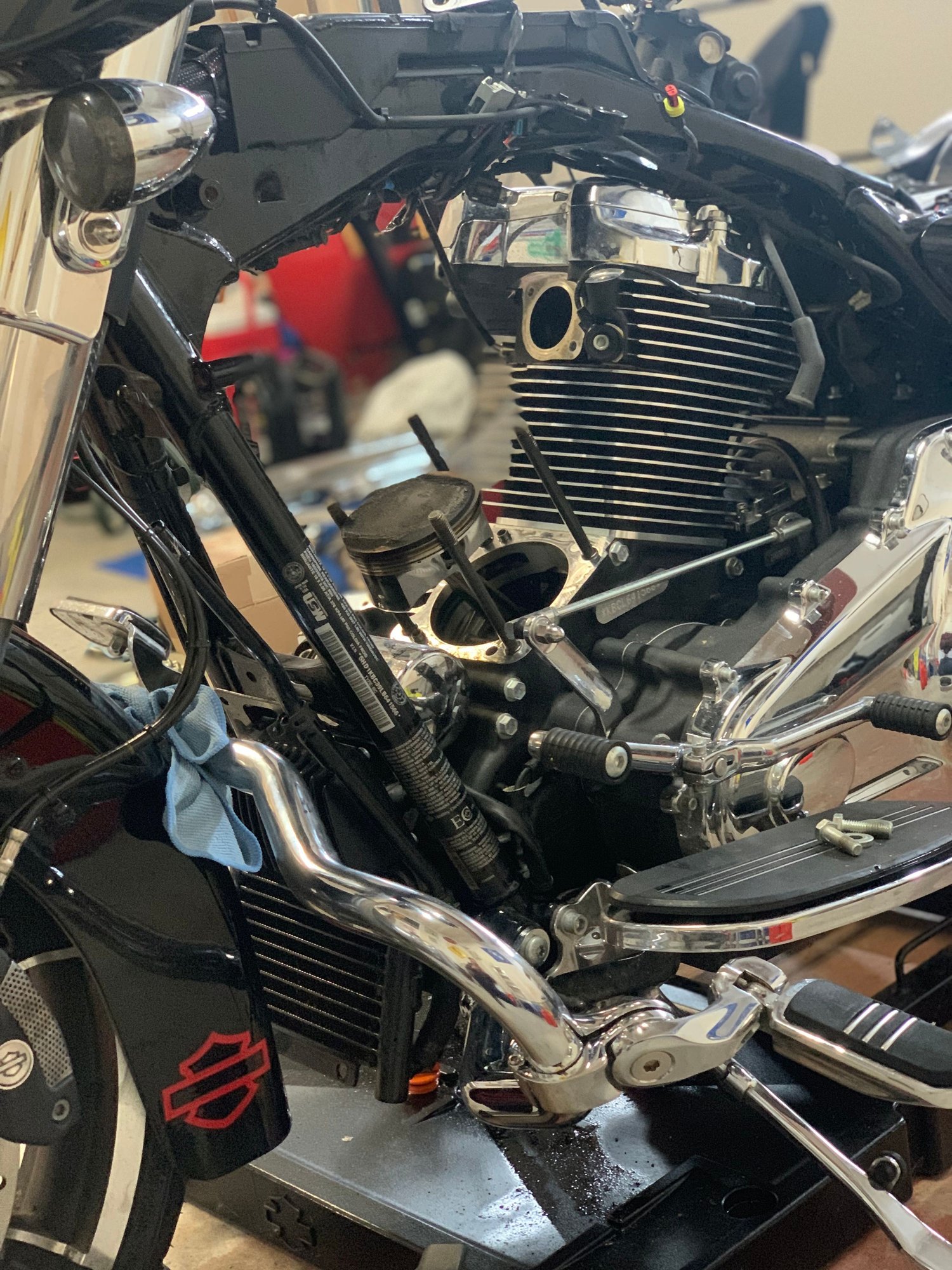

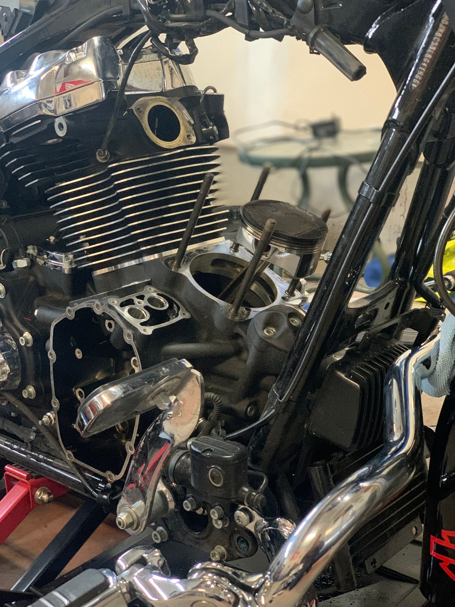

work got in the way of this project… however I just finished pulling the front cylinder
I can’t see a thing in there
looks like I need to invest in a boroscope
do they sell a boroscope attached with a magnet?

Yes. As I stated in an earlier post, I bought one that connects to my phone or laptop and has a magnet. They also come with small pickup tools for non magnetic items.
