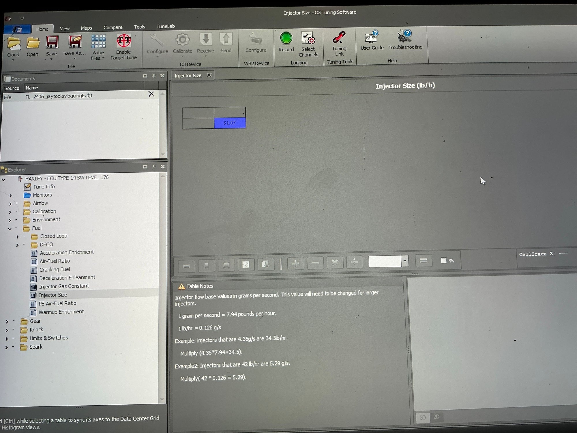

First I have a 07 96ci so there will be a difference. My set up power vision 3 and C3 software. I have novice credentials. Now whether you need bigger injectors is all dependent on your duty cycle, it should run around 60%. you will have to log it while running. If you’re at 90% you need bigger injectors, if you’re at 30% you’re getting out of efficiency. My C3 has a table for injector size, and you will have to do some math. Read the Notes. with whatever software you’re running look into fuel and injector size. pictures are included of my C3 tune. hopefully it is not password protected, as far as changing your injectors. Pull your seat and get to the bottom of the tank bolt. Unhook fuel quick disconnect underneath tank are your brake some parts. Then slide a 6 inch piece of 2 x 4 underneath the tank to lift the tank out of your way. Finally remove anything obstructing your path to the two fuel injectors, and your throttle body. Injectorsare usually held in place with one little bolt. it will take a little bit of wiggling to get them out, cause they’re out of kind of an angle, and they also have the wires that clip on the injector. and before you put them back in, make sure you grease the O-rings with generous amount of white lithium or you’ll cut them. it takes me about 10 minutes to change my injectors on my wide glide. It is very easy , make sure you lube the old rings before you put them back in. And make sure before you even take the seat off you unplug the fuel line from the tank. Pull your fuse to your fuel pump and start the bike and it’ll take all the pressure off the fuel line. I’LL SAY IT AGAIN UNPLUG YOUR FUEL LINE 1ST!!! Riding to Dyno, YES BUT FIRST TAKE A SHORT RIDE WHILE WATCHING YOU FRONT/REAR KNOCKS. Be gentle on throttle, if no knock then good to go. As with any unknown tune first make sure it’s not predicting are stumbling. Lean pre-debt blows holes and pistons! I have put a tune in that knocked one or two times before computer learned it, but I always have two channels set up to watch the knock.

Just open your map , change the injector constant and re-program. Good call on the 5.5's. Most 114's with a good cam need them. a 107 is pretty safe.

Easy peasy if you've got a laptop with bluetooth, or computer close to the bike. Yes you can run it open loop but can't think of a reason why. You may be ok to ride it 20 minutes but you've just added 25% fuel
