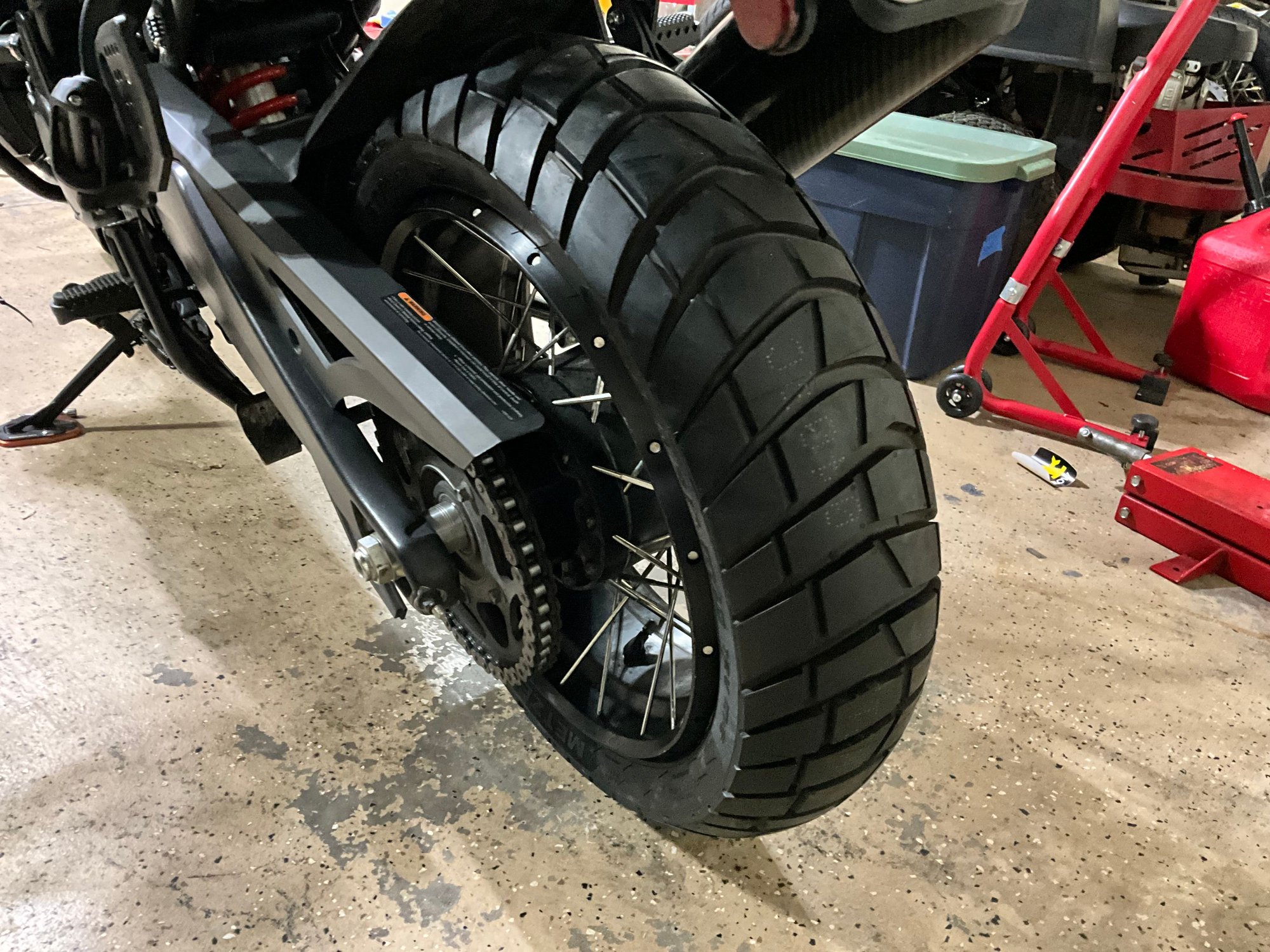

I installed Metzler Karoo Street tires and the look to be up to the task. Can’t wait to ride…
Would love to see a long term review of these tires!

it’ll be several months, it’s pretty much end of season here. They are a little noisier than the stock tires as they are a bit more aggressive, but I expect that’ll quieten down when the leading edges get a little wear. They seem to stick to the road well, I’ve hit some corners pretty hard and they felt sure. I’ve not been in dirt or gravel with them yet.

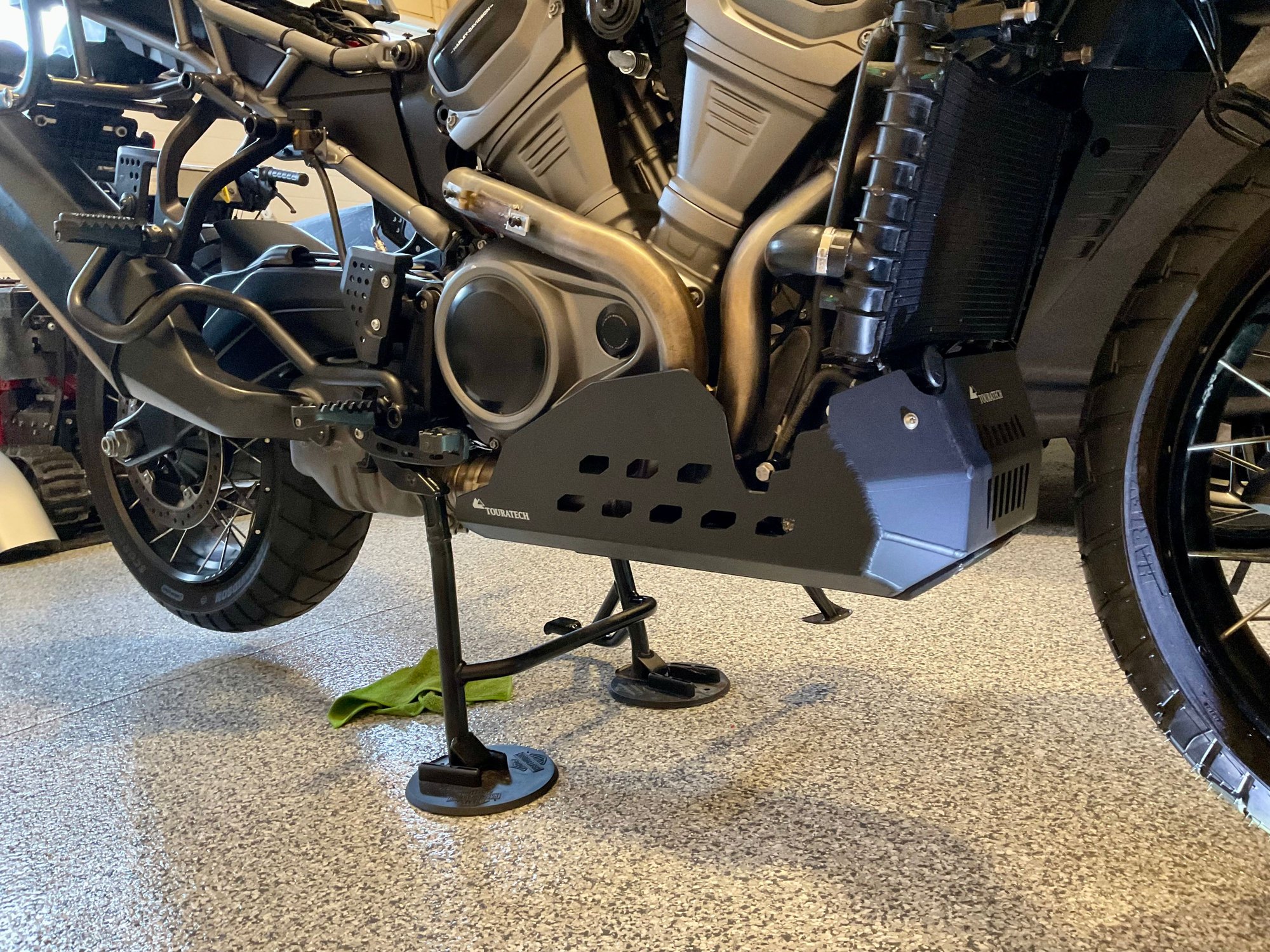

Just a little bit of extra belly protection. On sale too….

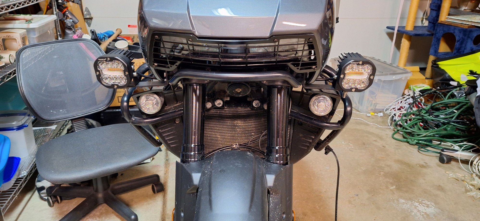

I now have the accessories for the front half of the bike done (oops, except for the radiator guard). I purchased a set of Denali aux light brackets made specifically for the PA and then installed my aux lights. I also added a USB Hub to the handlebars, and retained all the wiring. I bought an accessory harness from H-D for the Touring bikes and added four new takeouts with waterproof connectors. I should have made 5 (explain later). So I wired the GPS, the USB Hub, and the aux lighting to the accessory harness. The last connector will be for a USB hub inside the rear trunk for charging my laptop while I ride. The fifth, missing connection, will be needed for a new Innov v5 camera system I have yet to purchase. Not needing wiring but also installed is my roll chart holder for the TAT maps. Stuff is moving along!
What is left now is the radiator guard, the new bash guard, the rear USB Hub in the trunk, and new tires.
The headlight guard and aux lights.

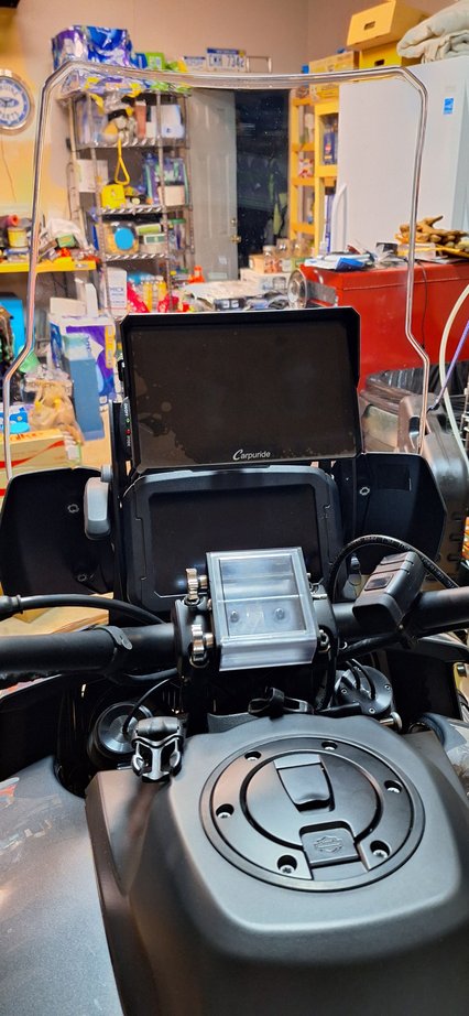

The view from the cockpit. The roll chart holder is in the center on the handlebars. The Carpuride W702 is up top. The switch for the aux lights is barely visible on the left side behind the Carpuride screen. The USB hub, with voltmeter, is just to the right of the roll chart holder on the handle bars.

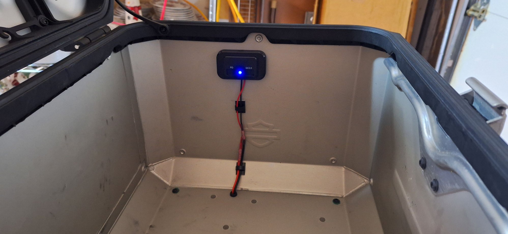

My project to put "power into the top box" is now complete. I drilled a small hole in the bottom of the box and used a grommet to seal it off. I put a waterproof 2-pin connector just outside of the box so the top box is still easily removable and this now brings accessory power to the inside. At first I put a USB Hub in the box but I discovered it would not charge my laptop. It did charge my phone, camera batteries, and Android tablet.

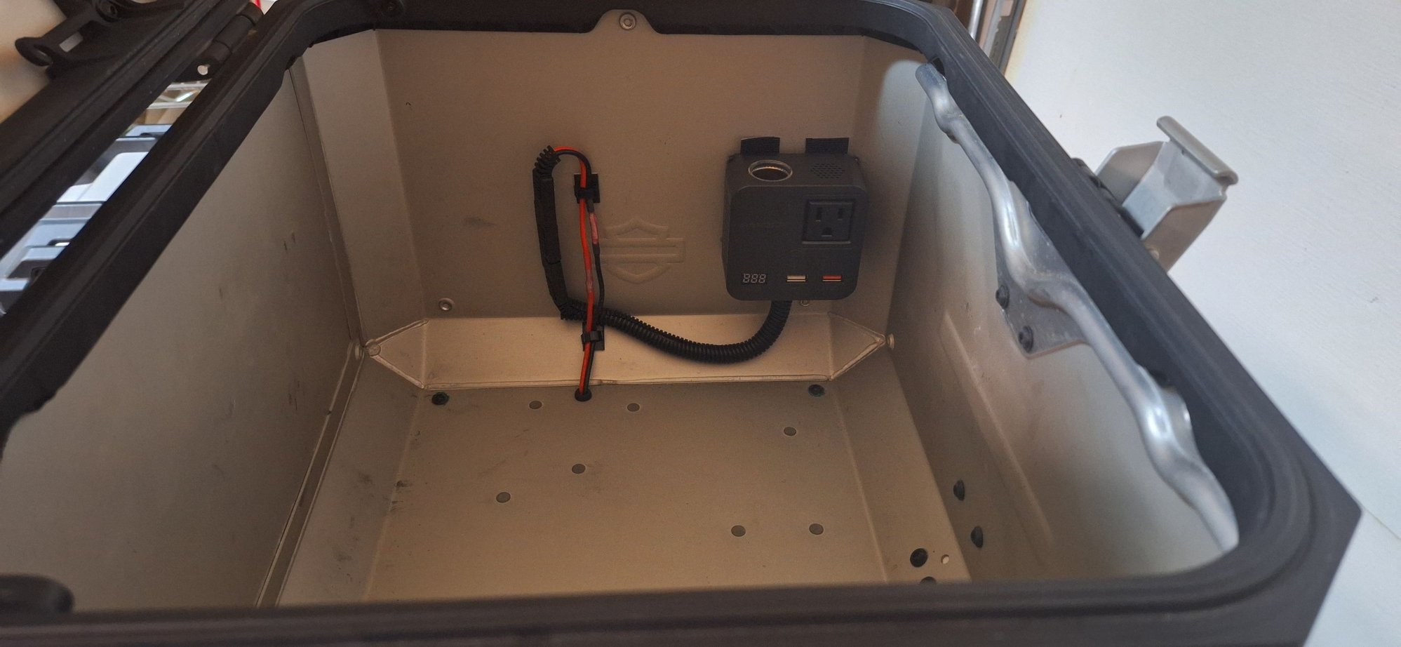

So I removed the USB Hub and changed it over to a 150w Inverter. My laptop now charges as it only needs 35w. This device also has 2 USB ports and a 12v power point pass through so I can also use my tire pump if needed. It will only pass a total of 150w and it has a thermal breaker, and high and low voltage shut downs.
So now I can charge my laptop and/or my camera batteries while I am riding on my trips. If I end up in a dispersed campground without electrical service for the night it won't matter.
