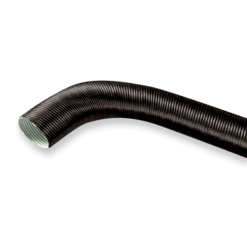

The only thing that causes me anxiety is the radiator hose being so close to the front header pipe. It's bad engineering & obviously dangerous. That hose bursts & coolant will spay the engine, leak down directly into the skid plate, & be funneled directly at the rear tire. Last I checked, coolant on tires isn't great for "grip". I'm surprised the DOT/NHTSA hasn't forced a recall. Even worse? That H-D hasn't taken it upon themselves to fix it & protect their "valued customers". Possible fixes are relatively easy & cheap- silicon instead of rubber hose, heat shield, header wrap, etc. The cheapest & easiest fix would likely be the DEI hose covers specifically made to protect from high heat (pic related below). Really, the MoCo has no excuses.
https://www.wunderlichamerica.com/wu...ator-hose.html
have this on order
