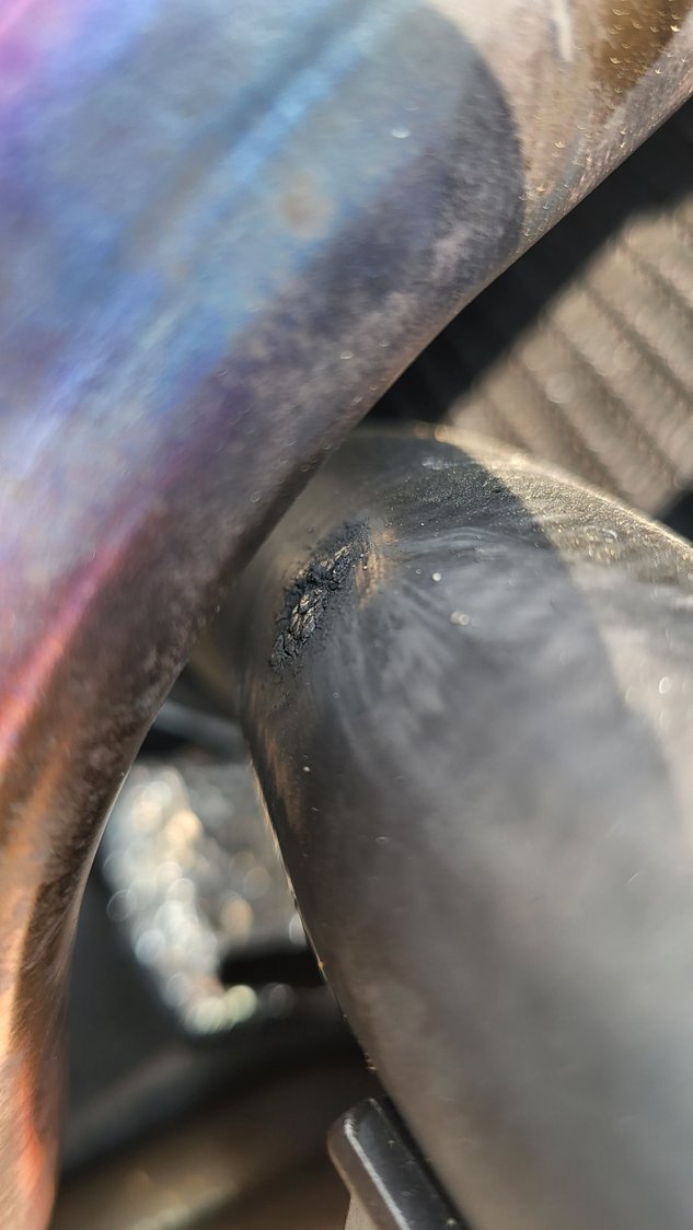

Originally Posted by silverbulletking
Maybe. I just got home after riding 200 miles (474 total miles ridden by me since I bought it on 6/5/23), my 2021 PA-S is running great, charging the battery, but I had the county tar my road so I had the tremendous pain of cleaning it when I got home. I'd ridden to the dealer I bought it from, they were hosting Adam Sandoval.
Anyway, while cleaning it I noticed a spot on the radiator hose near the front head pipe. I rubbed the spot, gooey rubber came off on my finger. The hose is melting from being too close to the header pipe (sad trombone sounds), but I caught it before it blew. I called the dealer, sent them pics (1 of which is below), & they said they'll come and get it again & fix it. The dealer is totally apologetic & I'm waiting for service to set a up a time for tomorrow to come and pic it up again.
Oh well, at this rate the whole bike will be new when I finally get to really ride it.
There's a pretty good chance that radiator hose will slip forward again after they replace it. They do have a fix, basically added a bolt to the radiator that a clamp attaches to, but it does require them to change out the radiator as well. I had to do a little pushing to get them to make the change, but I was also on my 3rd hose so they had a choice to see if it held, or hand me a new bike on Lemon law if it slipped again. They are basically calling it an upgrade part not a warranty part right now, not sure if it is standard on the 23 model or not.

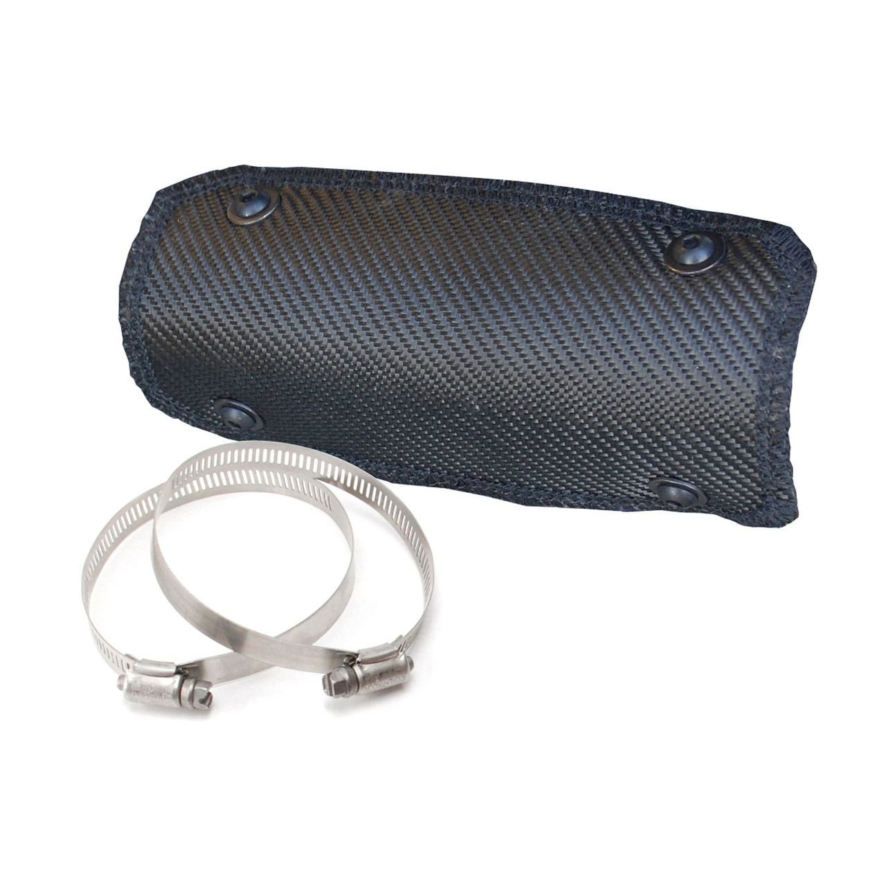

They can't pick my PA-S up until Wednesday next week, though I can bring it in earlier myself (with help from an old solution, I think can make it without bursting the hose). Per H-D, they can only replace the hose and they can only replace the hose if it's damaged (mine obviously is). So, even if it's too close, until the hose starts showing signs that it's breaking down- you as an owner are SOL. Hmm, it seems this is a somewhat common problem. Replacing a whole radiator just to fix it seems like overkill too. I think an enterprising person could mold a silicon radiator hose for the Pan Am & make themselves a few dollars.
Last night after a little thought, I decided to go with a fix from my youth since all I knew they'd do at that point is replace the hose- DEI exhaust wrap. I'm going to get some in black or one of their flexiblle heat sheilds (pic below). Both options are fairly cheap & both will work just fine I'm sure. I just have to make sure I don't go too thick if I use the wrap or that I don't get any rubbing with either solution. I'm going to think about the silicon hose though, quite a few options with 90* and 135* bends from at least a few manufacturers that I've already seen. Why the engineers at H-D didn't go with silicon in the 1st place (or now for that matter) with the header that close is beyond comprehension.

I had a few problems out of my 2017 Road King right off the bat (loose front brake rotors, non-activated alarm system, 2nd key fob not activated) but they were quickly remedied by the dealer & I had no other problems out of the bike for the 2 years I had it. So, a few hiccups don't scare me. Still, I've got what amounts to 2 rides on my PA-S & it's been to the dealer 3 times for repairs. My Sportsters & my Dyna never gave me a problem. Weird about the CVO, that's the MoCo's flagship product?
Oh, before I forget to document it in this thread, my PA-S also had a split on the heat shielding wrap/cover for the O2 sensor wires on my front header. The dealer said they'll check it out while it's there.
The only thing that causes me anxiety is the radiator hose being so close to the front header pipe. It's bad engineering & obviously dangerous. That hose bursts & coolant will spay the engine, leak down directly into the skid plate, & be funneled directly at the rear tire. Last I checked, coolant on tires isn't great for "grip". I'm surprised the DOT/NHTSA hasn't forced a recall. Even worse? That H-D hasn't taken it upon themselves to fix it & protect their "valued customers". Possible fixes are relatively easy & cheap- silicon instead of rubber hose, heat shield, header wrap, etc. The cheapest & easiest fix would likely be the DEI hose covers specifically made to protect from high heat (pic related below). Really, the MoCo has no excuses.
