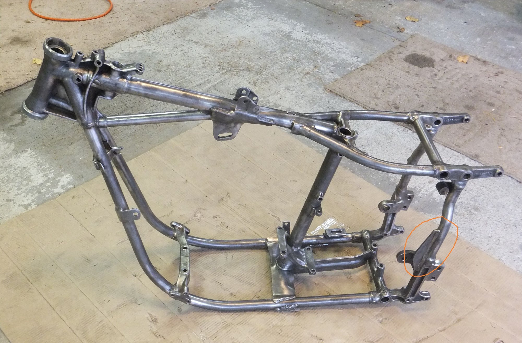

Yes, he is correct. It looks like this, and HD even sold a 'kit' to upgrade the earlier bikes.

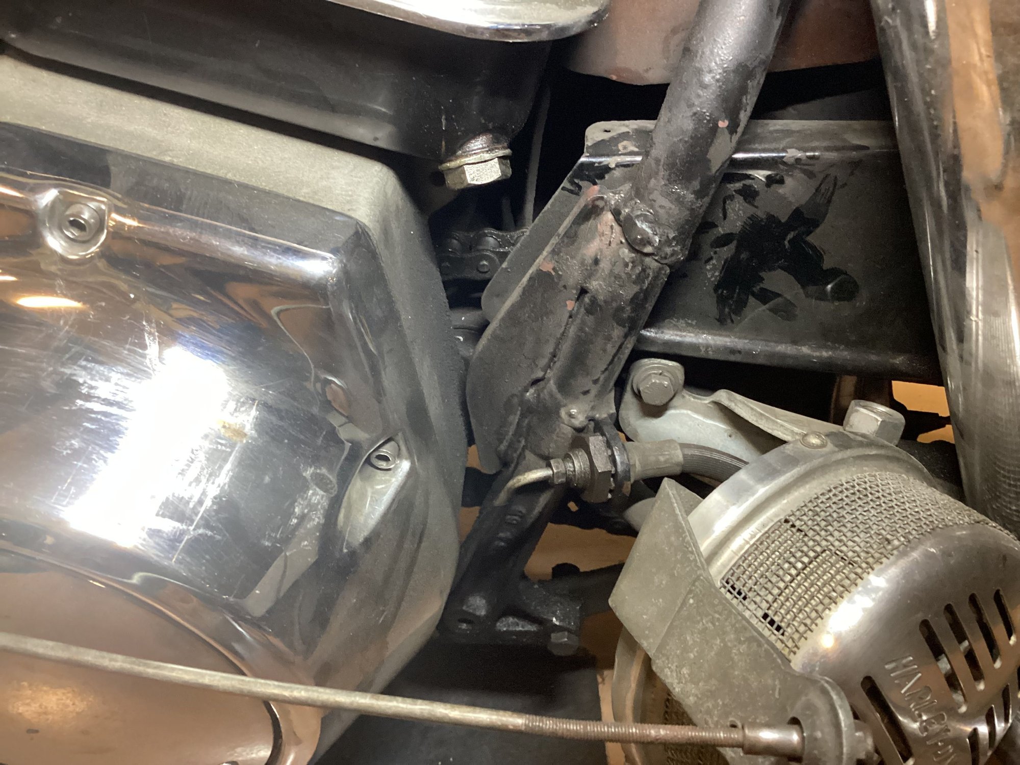

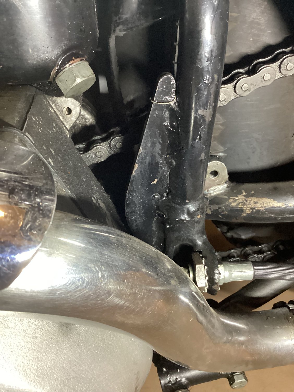

‘67 frame was cracked through when I got the bike. Buddy welded it up and added the plate. ‘69 has plate as well. ‘68 no plate.

How thick is it?? 1/4 inch? 3/16?
Old Apr 20, 2024 | 10:14 AM
FL54's Avatar
FL54
Joined: Feb 2010
Posts: 1,191
Likes: 574
1/4”.

Funny thing about this pic is that it looks like the frame broke at the end of the welded bracket.
I talked to my buddy. He broke his frame and welded in the bracket.. He seemed to think riding offroad hard broke it..
I don’t know much of the history of the bike other than it was torn apart for many years. The frame was cracked and my buddy welded up the crack and added the plate IIRC.

Gusset plate #47261-68 was available as a repair part for 58–early-68 frames. Apparently it was fitted as original on frames as of about mid/later-68. Here is page 73 from my 61–71 H-D catalog.
On another forum in 2011 a certain person said the factory offered a gusset plate as a dealer-install repair item as of the early-60s. But I found nothing about it in my 58–68 H-D catalog so I asked him if the gusset he was referring to was in any factory documentation and if it was the same style as the gusset with the -68 part number but he did not respond.
Several years after that someone else said the same things as that certain person so I asked him about it but he too did not reply.
