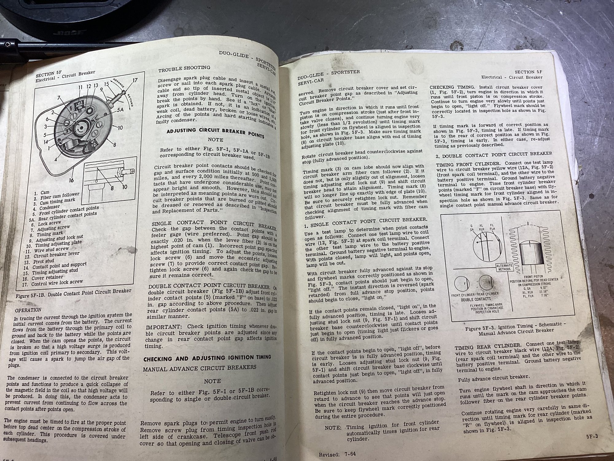

Aligning the fiber to the mark is only to set your point gap not to time the motor. Set the gap , I ‘m guessing .018 to .020. Don’t have the manual in front of me. Take out plugs, jack rear wheel off the ground and put the bike in fourth gear. Rotate engine until front cylinder is on compression stroke and mark is in the rear of the timing hole. Don’t know if you have a manual or automatic timer but should be on full advance. The points should just open (test light out) at this position. If not, adjust accordingly. This is all covered in the service manual which I assume you have. If not you need to get one. Good luck.

From ‘59 to ‘69 service manual but should be the same for your bike.
