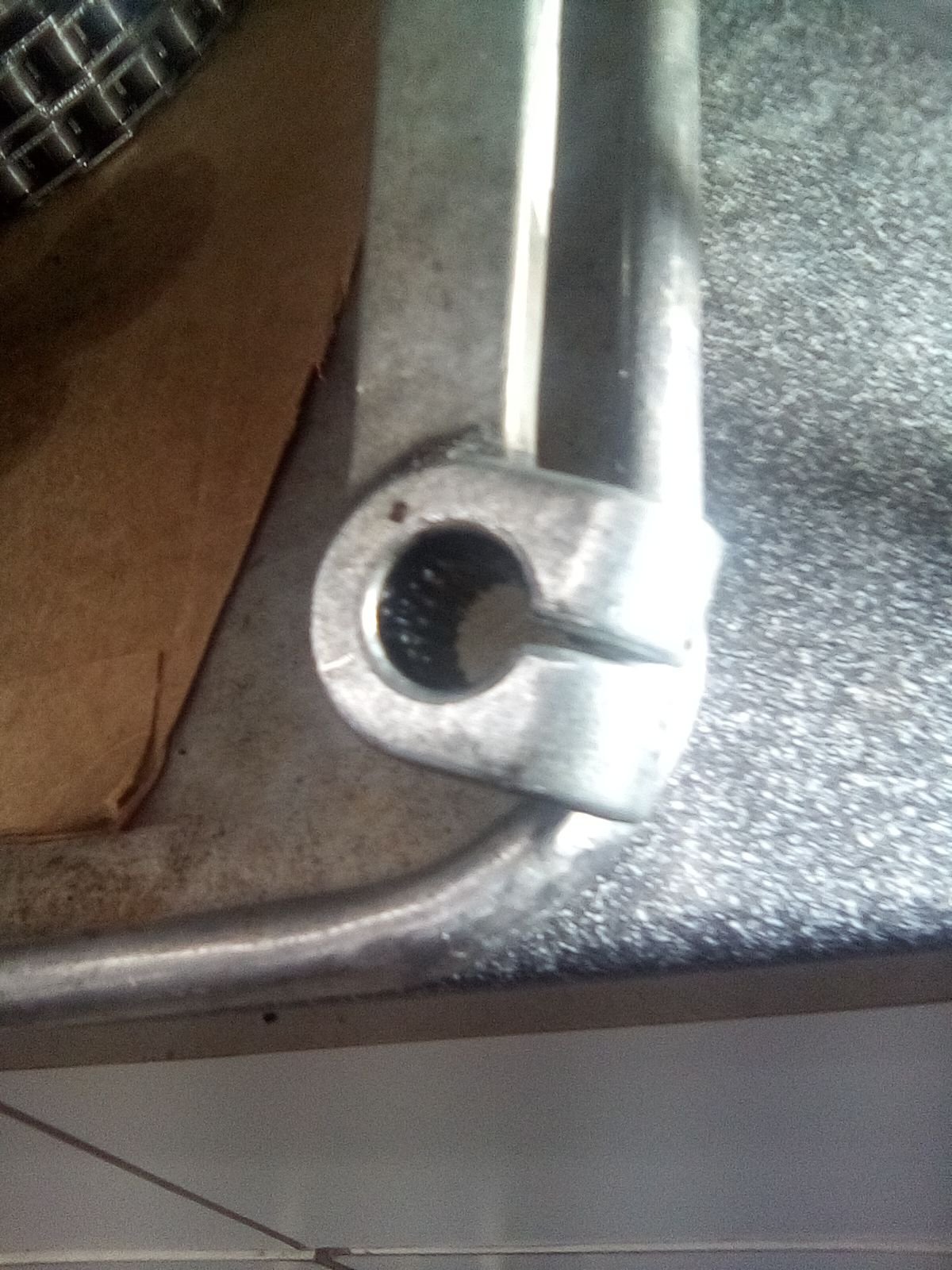

Here's a picture of the parts I need the splines are stripped on number 2
and 12

In order to replace the shift spline, you have to pull the tranny to get it out.. You might want to try and clean the current one up and simply install a new lever. The main reason for the arm stripping is allowing to run it loose... There are some aftermarket arms that can get additional grip on what's left.

Hi Max. I've already got the inner and outer primary off and all the components out. The shifter shaft lever splines don't look as stripped as the one on the shift lever itself. I've gone this far already. You can take the gear set out on the trap door without removing any of the gears it comes out as a unit. I'm heading to the dealer and JP cycles now in Ormond Beach Florida their night next to each other. My question to you is does
V-Twin manufacturing or drag specialties make quality parts? I will keep you posted thanks for your reply. Here are some close up pictures I know the quality ain't great but you can see splines are stripped worse on the shift lever
