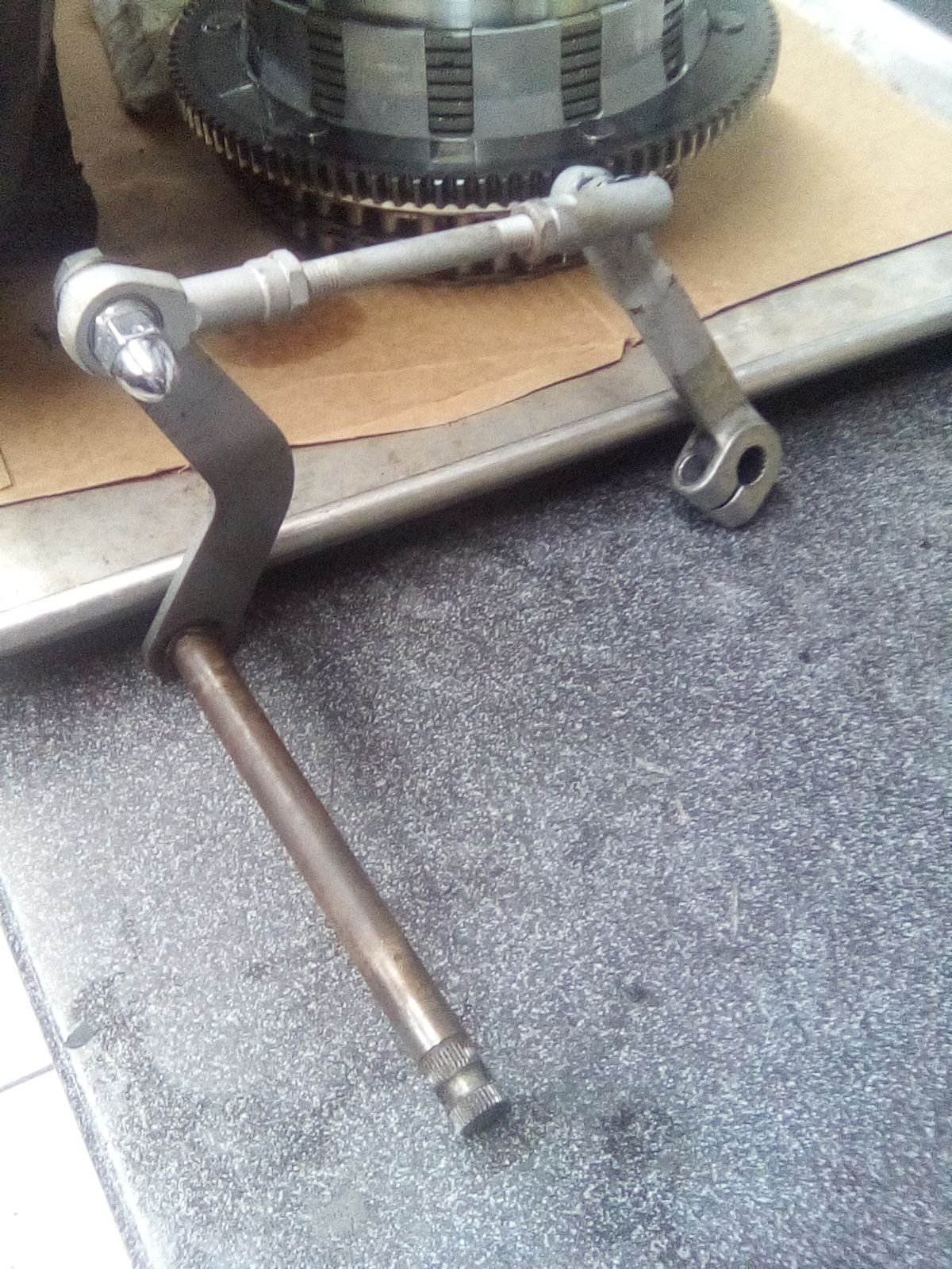

Well I finally got around to working on my fxd I've been riding my St. I've decided to fix it right and change the shift pawl assembly. I will be changing the main shaft bearing race to an S&S. I'm also changing the inner primary bearing to an S&S but I saw a made in Japan on it does anybody know if any good ? Or is there a better American made timkens or something
Does S&S make a shifter pawl assembly?
The front shift lever splines are stripped also. I would like to change the whole linkage from the front shift lever all the way to the transmission shifter rod. I have mid controls so the front shifter shaft goes through to primary.
I know Baker makes a shifter pawl that fits but it's a little too much money . Are the v twin and drag specialties any good parts or
I would like to buy this whole thing linkage shift rod and lever splines are stripped on both ends
Unfortunately the shift  rod pawl assembly splines are stripped. I want to replace this with a quality part

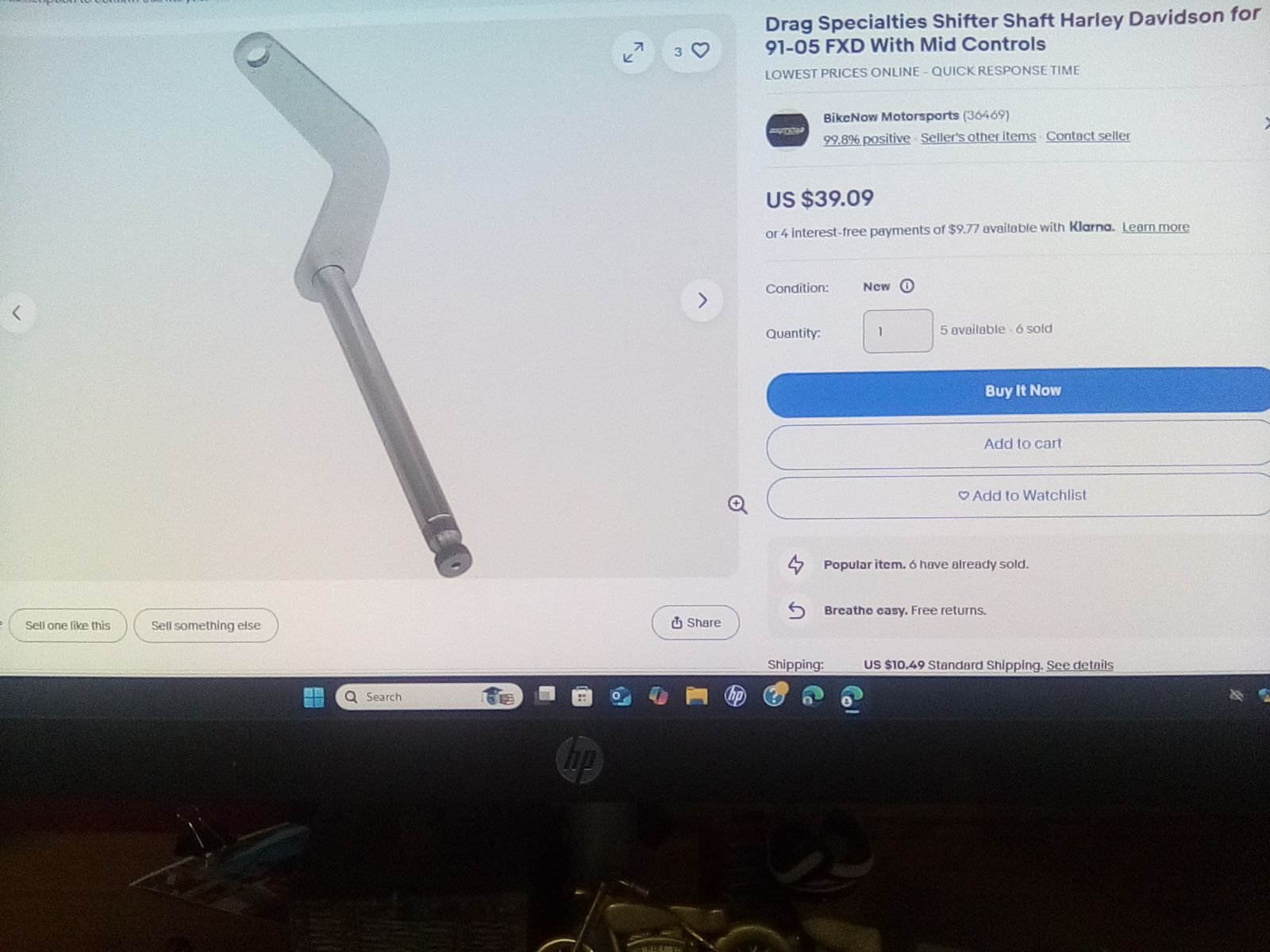

Is this a quality part?
Chinese junk. Thank you in advance for any advice.

Okay been shopping around it seems that Jim's only makes them up to year 2000. Can anybody confirm this.
